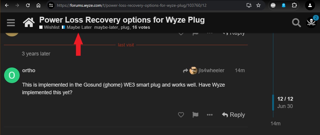

+1 for this: would like to be able to use the plug in a switched outlet and default to ON when power is restored.
This is implemented in the Gosund (ghome) WE3 smart plug and works well. Have Wyze implemented this yet?
No, bulbs only. Hence the status of this wishlist topic:
Please click the “Vote” button in the upper left corner of this page.
