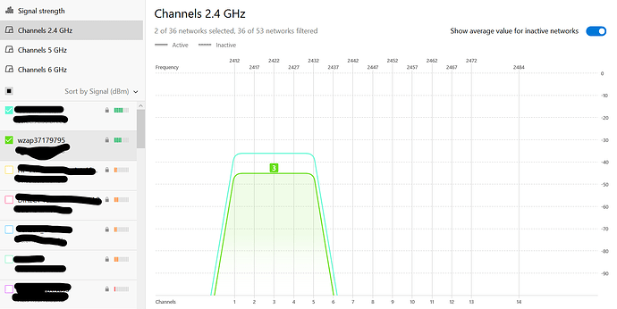

I suspect it uses the same channel that it connects to your wifi. Mine is 1 or 6, not 11.
