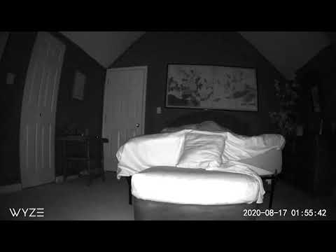

These are the sorts that I get. But I also get them larger. I see the light even getting larger on the bedroom door on your video.
my videos are also showing all sorts of noises but it’s super quiet out there so there shouldn’t be noises.

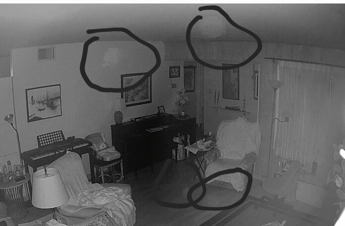

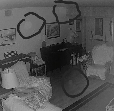

I try to upload a video that show orbs in my livingroom i heard two people pass in this house so i believe its more then just dust.

Anything that floats\flys in the air and passes incredibly close to the cam lense will cause an image distortion that is out of focus. It will look large because it is so close to the lense even though it is microscopic and will be seen as a blurry distortion because it is too close to the lense for the cam to macro focus.
This occurs at a much higher frequency when the Infra Red Night Vision is on because the IR light source is coming from within the cam and reflecting directly off the near object back into the lense. It is rare to get them when the IR NV is off because the lighting source is originating from outside the cam and not illuminating the cam side of the object near the lense.
It is essentially the same concept of having a blurry spot in the image on a DSLR Camera when dust gets on the mirror or inside the optics on the lense. It can’t focus on the object and light is caused to refract around the object.
This will happen with bugs, dust, pollen, bugs, water vapor, spores, did I mention bugs? Yes … Lots of bugs, spiders and other creepy crawley things.
Edit: you will probably see a lot of white streaky flowing things too, sometimes with glowing nodes on them: Spider web silk flowing in the air current.
