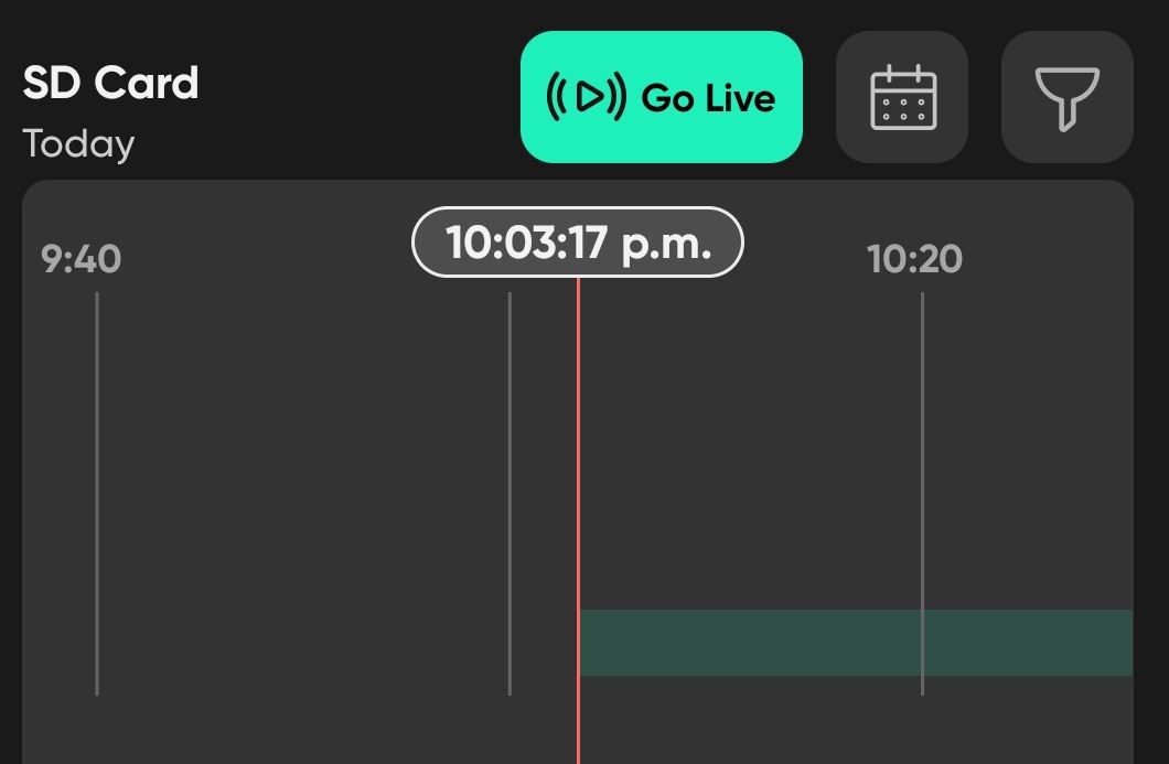

I ran another test:
  • Older OG with Firmware v1.0.98
  • Android App 3.18.0.918
  • Set SD Card Recording to Continuous.
  • Used my ISP App to Pause Internet to OG for 40 min.
  • A few seconds later OG shows as Offline.
  • After about 30 min WYZE App notification that camera is offline.
  • After 40 min OG shows as online.
  • See SD Card Timeline screenshots.
    • Appears to record while offline for 40 min
    • Short gap after 40 min (index 10:43) - when reconnected?
    • Another short gap 11 min later (index 10:54) - not sure why.
  • Skipped through the 50 min of video (40 offline + 10 online) and seems OK.
Does this mean that 30 min issue has been fixed?
Unfortunately my laptop doesn’t have an SD Card reader so I can’t examine the SD Card.
