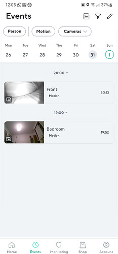

I set up the motion and sound detection on both cameras, The motion event has triggered and notification was pushed. I waited few hours to see if any more events get triggered. But they did not! It detected thing only one time per cam:

It now looks like this:
The second camera didn’t trigger any events. That is until I restarted it. Then it worked but still no notifications pushed.

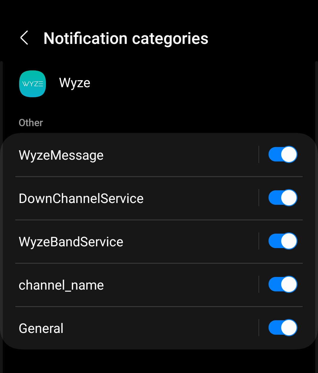

I toggled the notification settings in the app and double checked system settings:
I reset the app data. No notifications were issued so far.
That’s my experience so far.
