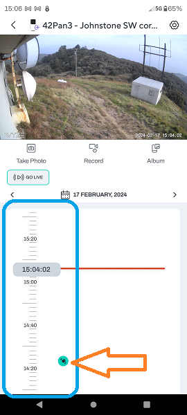

First of all. Your text says Pan V3, but the link says V3 Pro, but the link goes to the Pan V3. So hopefully that is what you are talking about. However both use the “new” UI but because the Pan is a Pan camera, it looks a bit different. My screen captures are from a Pan V3.
In the image below, the red arrow points to the SD Card icon. That gets you to uSD Card playback. More on that in the second image. At the bottom of the screen capture in the green box is recent events. More on that in the 3rd image.
When you click on the SD Card icon, you will get the timeline as seen below in the blue box. Any events will have an event type icon as pointed out with the gold arrow. In this case, it is a sound event. You can scroll up and down along the timeline, or change dates from the left and right arrows above the blue box, or select the date and that will give a calendar to select the date.
In the last screen capture, if you swipe up on the Recent Events label as seen in the first image, you will get a listing of events. You can scroll up and down to see more events and if you select an event (the red arrows), you will see that event.

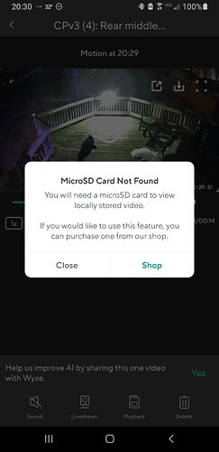

For Cam Pan v3, tapping the Playback button on the event screen from a notification is bugged.
Depending on your app version, you’ll either see grayed out text under the Playback icon and tapping the icon is inoperable or you’ll see a “MicroSD Card Not Found” error message when tapping the Playback icon even though you have an SD card installed. I’m not sure what the status is on this fix. Perhaps @WyzeJasonJ can shed some light on this issue.
Variation1 (seen in current production Android app) : Grayed out text under icon/icon inop:
Variation 2 (seen in current beta Android app): MicroSD Card Not Found:

I have issues with Pan Cam v3 reading from the SD card. I have submitted log 324249.
At least I know I’m not nuts, or too stupid to get this working. I can also send in logs but sounds like you have enough of them already and they just need to find the time to get it working.
