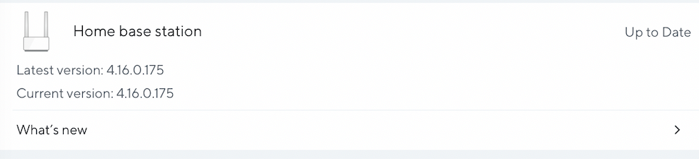

Not seeing any issues on mine upgraded to .191 on V2s, .175 on base, or .173 on WCO… 14 have upgraded fine so far. I have 23 cameras between two locations

I don’t see any updated release notes for WCO & Base
Still same release:
4.17.0.159 (September 9, 2020) WOC
4.16.0.168 (September 9, 2020) Base
Are you on beta? Wonder why you aren’t being offered later version?
