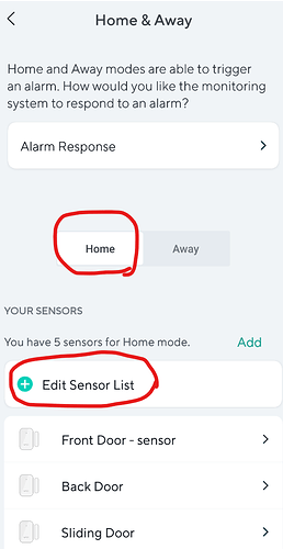

Select Home and Away Setting:
Click on Home and then Edit Sensor List

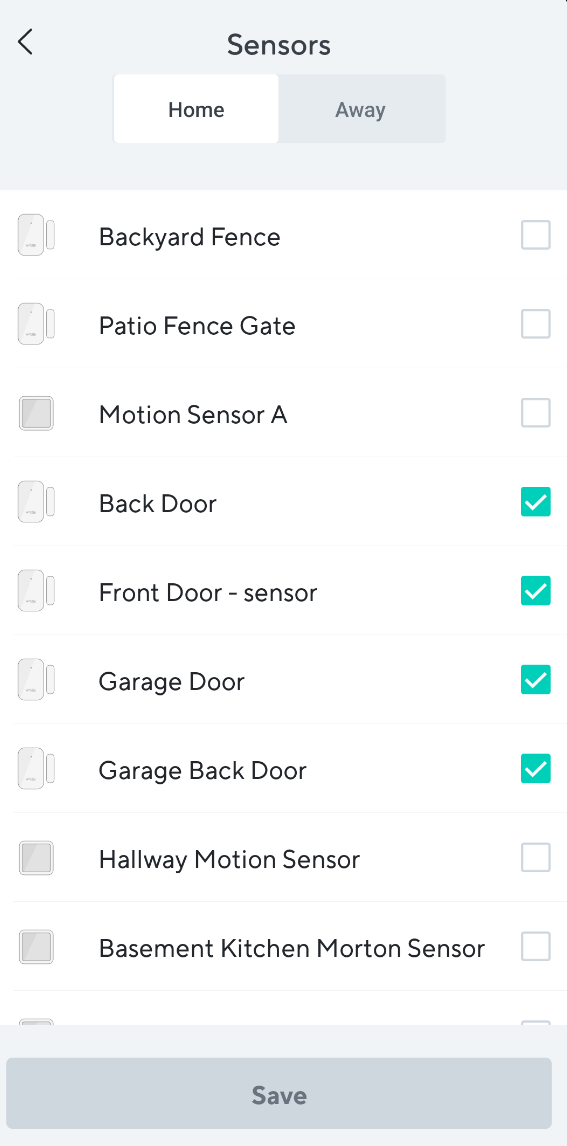

Then make sure you have all the sensors selected that you want to be “Armed” when you arm as “Home”
Then Save and do the same for “Away”
