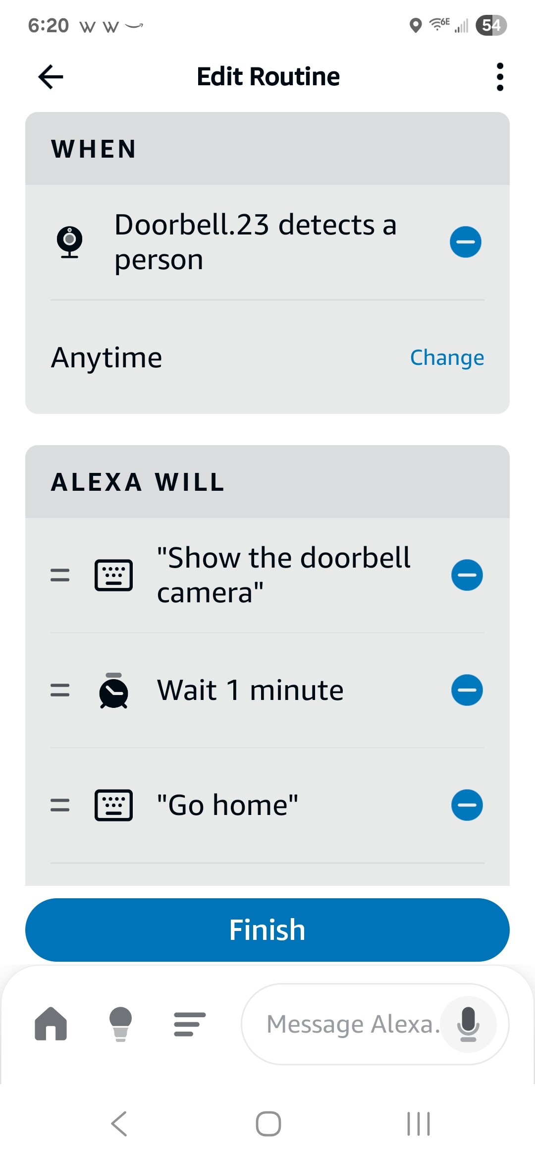

@WyzeJasonJ,
Log ID 1906751
The following video shows the issue:
Wait a minute or so for the sound.
The Alexa routine is very simple:
