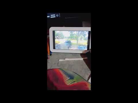

Yes, its a problem with old and new models that are connected and trying to view a livestream on Amazon Echo. See the attached file for an example.
