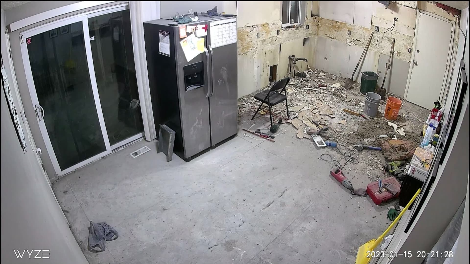

We’re remodeling our upstairs kitchen. We had to replace the dishwasher and kitchen sink valves (they wouldn’t turn off). After replacing them, we turned the main water back on and everything looked fine: NO VISIBLE LEAKS upstairs. We went on tearing down the rest of the upstairs kitchen (removing the floor, ceiling, cabinets, etc), when suddenly the HMS hub was beeping, like an entry delay. I was really confused since it’s not during the nighttime armed schedule and no visitors could’ve turned on the HMS by accident.
