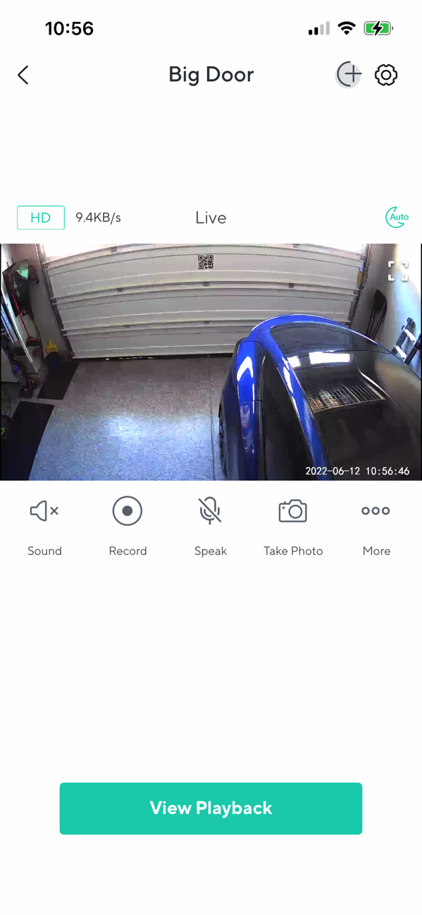

  • Picture of where the Camera is installed
  • Picture of what the Camera sees in relation to the QR Code

Please see attached pics.

Thanks for posting the pic of your setup.

Wyze just added a feature that shows text of the status of the door as 'Garage is Closed" or “Garage is Closed”… and tonight… it’s stating the wrong status… as the picture shows it’s clearly closed (this is the 2nd time I’ve noticed this issue)
I opened, then closed the door and it changed to “Garage is Closed”
It Appears that the GDC’s ability to determine if the door is open or closed is challenged.
