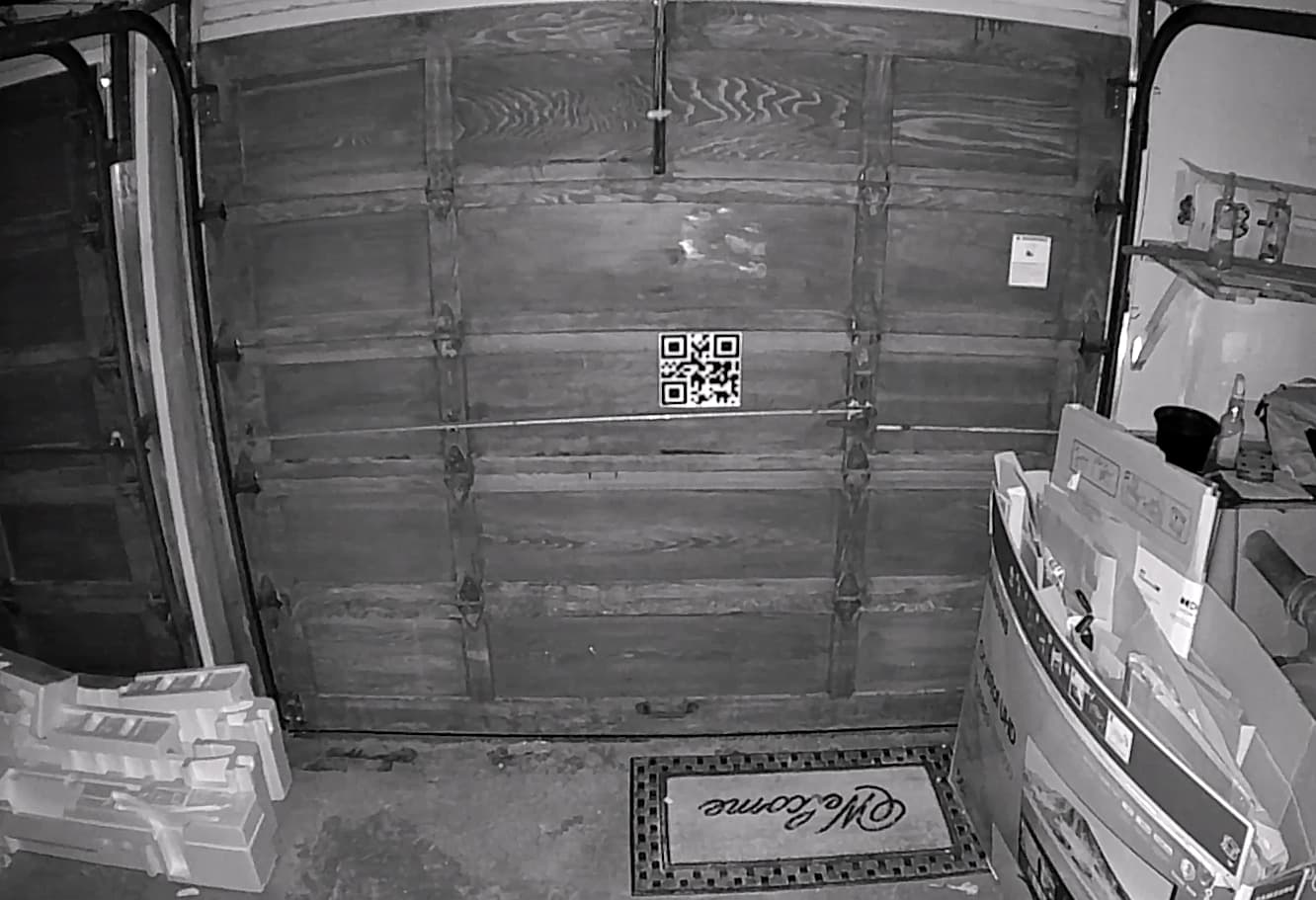

The camera part works great as usual but the garage door opener just does not function. The QR code is clearly visible, in fact I moved it down a little to make sure it sees it. Could it be that when light comes on it forgets the door was opened or closed? Like what are some suggestions to fix this, it’s so frustrating coming home with bags of groceries and I can’t open the door. (I don’t have any other remotes to operate)
Is this bad placement for QR?

My garage door is about 7ft high and the door opener is no farther than 8ft. It’s clear wyze cam is still having trouble recognizing the QR code, even though it recognized in the beginning but eventually loses track of it. It can see it with red icon as you can see above.

Your position looks great; you shouldn’t need to enlarge anything. Yours is right where it is supposed to be.
What I wonder is about drift. A garage door opener can shake. My camera is only magnetically mounted, but I made sure the magnet wasn’t under a hole in the angle iron, so it would hold the best. I’ve never had to recalibrate, so seems to be working well. Is yours a solid mount? Or can it slowly vibrate out of position? Even if it drifts, it should be able to be recalibrated to the new position, tho.
