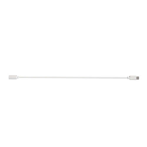

It was from last March or April so I’m thinking it didn’t come with an adapter cable. Where do I get the adapter cable for the older Wyze solar panels to USB C?
Playing automatically shouldn’t require a tap in group view with Battery Saving Mode toggled off.
So are we SOL if we have existing Wyze Solar Panels or ordered one 2 days before release? Seems silly that the Battery Cam Pros itself didn’t come with an adapter for microUSB given that has been the standard on all Wyze Products
How is that an adapter for the Wyze Battery Cam Pro? It needs to be MicroUSB to USB-A receptacles so we can use that flat/flush cable that comes with the camera. That will stick out from the bottom.
That adapter converts the USB micro connector at the end of the Solar Panel cable to the USB C that the Battery Cam Pro needs.
Since May 2023 they have been including this cable with new solar panels.
Thanks much! In the photo it doesn’t look right angle though.
Ah, yes. Sorry about that. I must have been thinking of the Pan V3, which needs a right-angle to use the base mount correctly. The Battery Cam Pro has a rear mount, and thus you can use a straight power connector on the base, no problem.
I edited my post above. :slight_smile:
