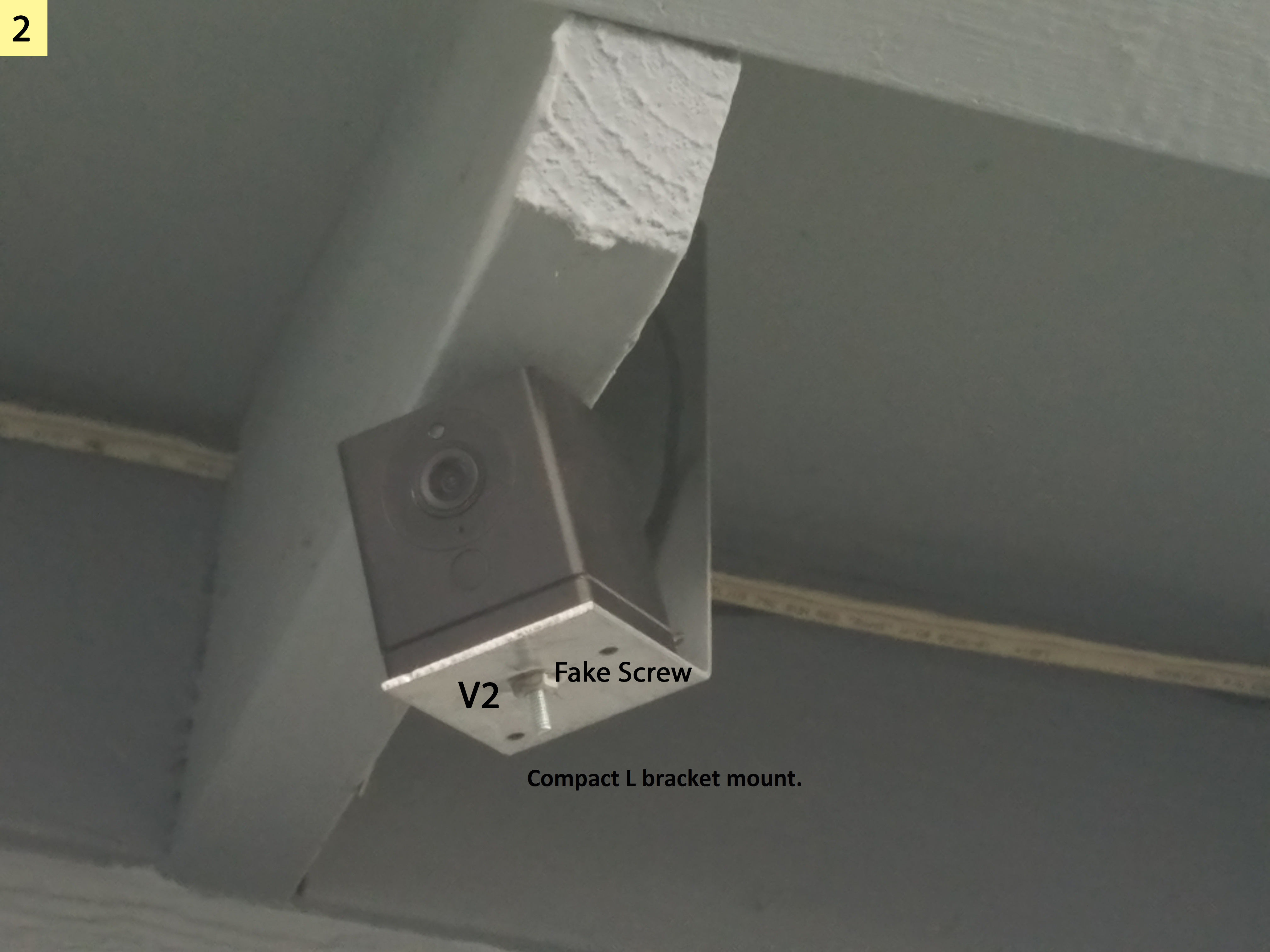

Picture 2 is the exterior camera mount. For those with a window option, the camera could be placed inside aimed towards the area of interest.
