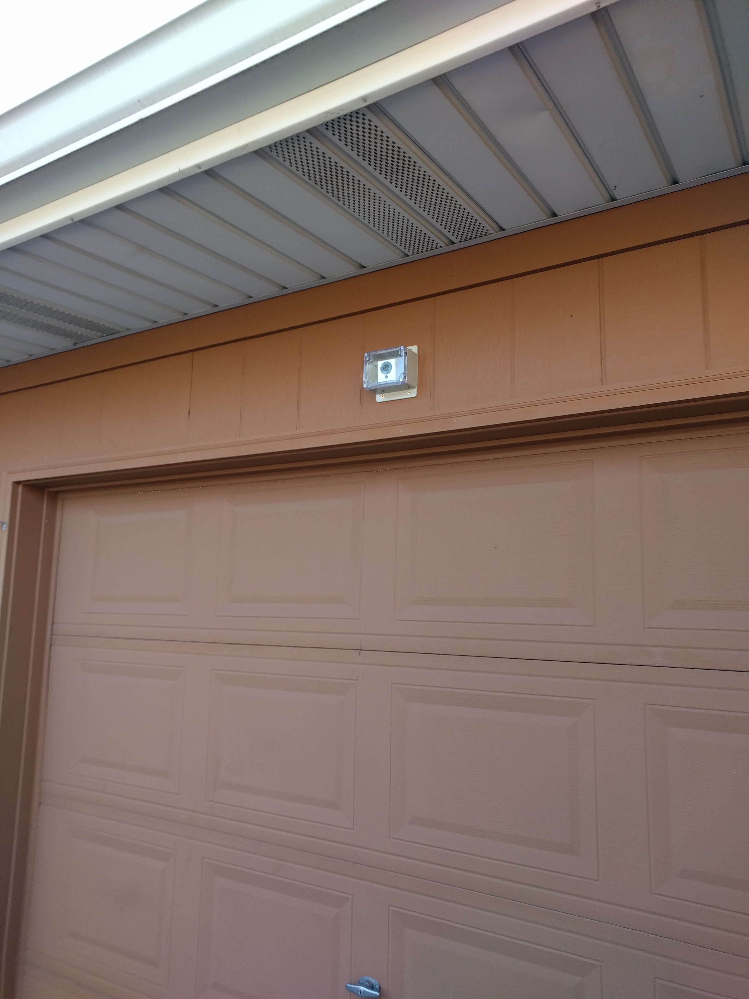

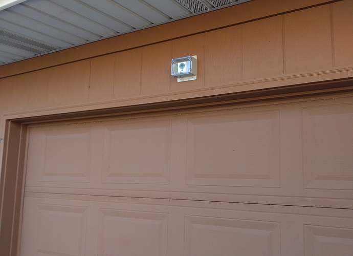

Hi,
I’ve read a few threads where customers have installed the WYZE Cam outdoors and thought I would add my version.
My single daughter wanted an inexpensive way to monitor the goings-on outside her duplex. She already owned one WYZE Cam so I purchased her another for outdoor surveillance. I knew I wanted to use an sealed transparent box that I could mount above her garage door so I purchased the Uxcell 4.53"x3.54"x2.16"(115mmx90mmx55mm) ABS Junction Box Electric Project Enclosure Clear from Amazon. Small and unobtrusive the box was just large enough for the WYZE Cam, it came with a weatherseal strip and box screws. I only had to supply the deck screws to mount it above the garage door. I drilled a hole through the back of the box and through the garage wall. For a power source I ran an extension cable from where the garage door opener plugs into. She owns a Netgear R7000 router which has more than enough WiFi power and range to reach the WYZE Cam outside. It’s been up and running for a week and she’s quite happy with the results.
Great idea! If you didn’t, you may want to putty or caulk the hole closed to avoid condensation from a temperature differential. If you want to go nuts you could seal the hole and toss a desiccant pack in the bottom of your enclosure also. Great job!
Nice!
Two questions…
  1. I'm assuming the night vision doesn't work through the plastic lid, right?
  2. Do you think it will overheat in the summer?
I think if it were me, with the overhang available in the location, I would have just mounted as high up under the overhang as I could get it and not worry about it getting wet. Then the night vision would work and heat would be less of a concern in the summer.
Thanks! I’ll have my daughter monitor for any moisture condensation and if it becomes a problem I’ll try your suggestion and seal the hole in the back of the box.

The camera box faces east and being under the overhang generally doesn’t get much wind driven rain or snow…but it is something I’ll have my daughter monitor. The box itself has a decent weatherstrip that runs around the edge perimeter. If rain started sneaking around the backside of the box my first inclination would be to use some clear silicone caulking where the box meets the garage wall exterior.
The night vision does work but in my daughter’s case it gets blurred by the motion detection outdoor light that comes on whenever someone or something comes within range. So for night vision it’s not the best scenario. She could turn off her outdoor light but she’s not sure she wants to do that.
As mentioned in my previous post it does work but the night vision feature is compromised by the motion sensing outdoor light fixture. And it’s not glass but a plastic enclosure.
