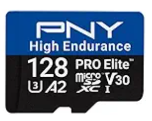

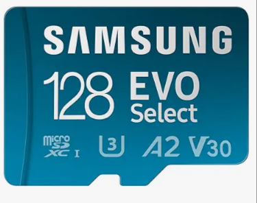

Care to mention the SD cards you have tried?

I have always used cards spec’d at SDXC, C10, U3, V30, A2. A mix of different trusted brands. They all behaved well, up until recently in four of my five v3s. No issue in one of my v3s, or all my other Wyze devices. Only the four v3s in question exhibit the issue. And only within the last couple months. And I’ve bought new SD cards, with the same results. It’s not the SD cards.
Edit: And I’ve rotated all my SD cards on hand, brand new and older cards (a total of 12 cards) through all my v3 cameras. The behavior stays with the cameras.
