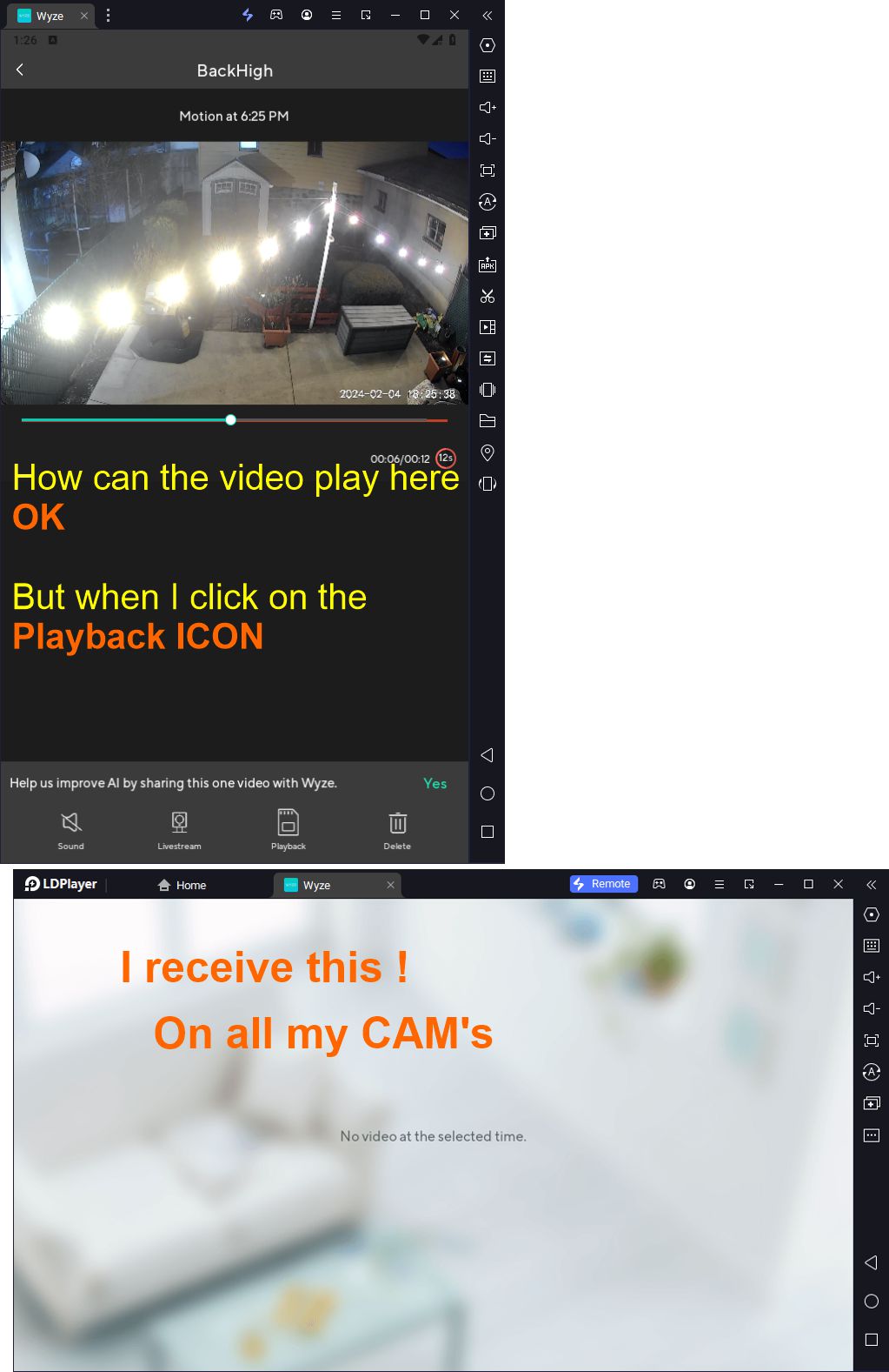

Did not format the card, tried checking video recorded on the microSD. The “Events” play the video when I click on it, but when I click on the “PLAYBACK MicroSD Graphic icon, in the app. It also says " No video at the selected time”
Even though is shows an “event” with a image/video snapshot to reference this video/image captured.

On the two pictures you show though, those are 2 different things, your first image in an ‘Event Video’ those are not on the microSD card they are in the cloud. The second pic is the microSD card video that says ‘no video at the selected time’. That means your events are recording to the cloud but are not saving to the microSD card. This is why I would recommend swapping cards first to see if that is the issue.

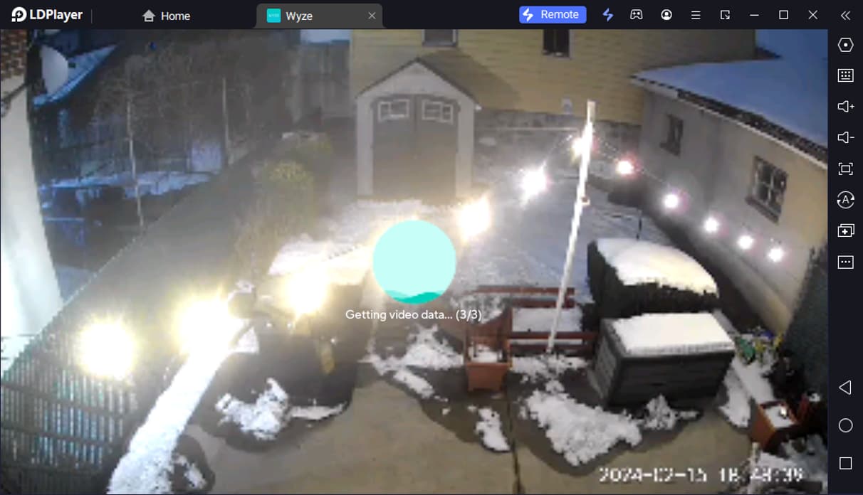

When I click on the microSD, for a split second I see a screenshot (with the Green Circle filling up/trying to load up video) and then it goes into “No Video at the selected time” …The static image, that shows for a split second/s before it tries to connect/load the microSD, does show the date/time, but that preload image is pixelated, to where the date/ time cannot be clearly identified, if the time/date is the same as the Cloud Video. From what I can make out of the pixelated time stame, it does look like the date is wrong on the static loadup image compared to the cloud date/time. Date of Cloud Image is 2-10-2024, pre static loadup image prior to trying to load microSD looks like it is 2-15-2024, which is odd, as that is today…— after the split second preload up image, then it displays “No Video at this selected time”
To me, it points to reference image link corruption, from everything I see happening /experiencing.

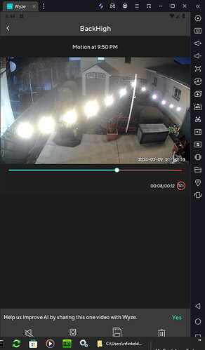

Does the timeline itself below the view jump to the correct time?
Not sure if I am understanding your question
As there is no timeline, OR video played when I receive the error of
“No video at the selected time”
If I click View Event
I will see this
If I then click on the microSD card graphich in the Wzye App
I will see it trying to load the microsSD card referenced video
for a few seconds, before I receive “No Video at the selected time” error
In those few seconds of loading, (Bottom right time mark, is pixelated, so I can not easily ID what the time stamp is, but it looks to be 2-15-2024
Not matching the “Event” view time stamp of 2-9-2024
I actually now understand what you asked
3rd image of the “No Video at the selected time”
does show a Timeline, on the “No Video at the selected time”, screen.
DOES show the SAME timeline position, as the “Event”

The timeline in your third photo was the one I was talking about. You are probably correct if they are now working it was probably a cloud issue with either Wyze or one of the partners we use on the cloud side of things. Please let me know if it starts to happen again. Sorry for the frustrations.
