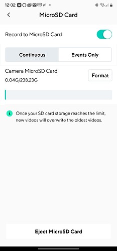

I am back to the video not available issue with the pan v3 cam I thought was resolved. The screenshots below will show you my dilemma.
As the images show, the card has been recognized by the camera but is not recording the images for playback to the sdcard. It is displaying a count of the number of images but failing. This is brand new sandisk 256gb high endurance card that failed to install and then reformatted with SD Card Memory Formatter and multiple factory resets of the cam. The pan v3 is beyond the 1 year warranty and I am not going to waste anymore time.
@WyzeMengtingHu @enting.sung as I am now back to square 1 with the cam and sdcard recognition and sdcard recording, I’m writing this off as a defective camera issue that won’t be replaced because the cam is 2 yrs old. Useless for me to submit a log. I might consider replacing next sale and although the location is ideal for the duo cam pan, I am not ready to get one yet.

I think you are in event only mode (as shown in the screenshot) - could you switch to continuous and see if the issue still persist?
Yes, that is correct. I have never recorded in continuous and have never had this issue. I have a 2nd pan v3 in service now set to events and it works fine. I will switch this cam and report the results.
Oh it definitely persists in continuous record mode too ..

@WyzeMengtingHu I can concur with @bryonhu that the issue exist also with continuous. Same label with number but no video to playback. I can also report that the sdcard status is showing the same data used number after several hours further identifying that no video is being recorded by the camera.
Firmware or hardware issue? I suspect hardware.
From the screenshot, since it’s event-recording only and the timeline indicated that it was in between events, essentially there’s no recording hence “no video available“ is expected. However, if the issue still exist with continuous recording, and we can get a log for that, I can ask team to look into it and see if we can reproduce it. Sorry about the experience, trying to help here. -Mengting
