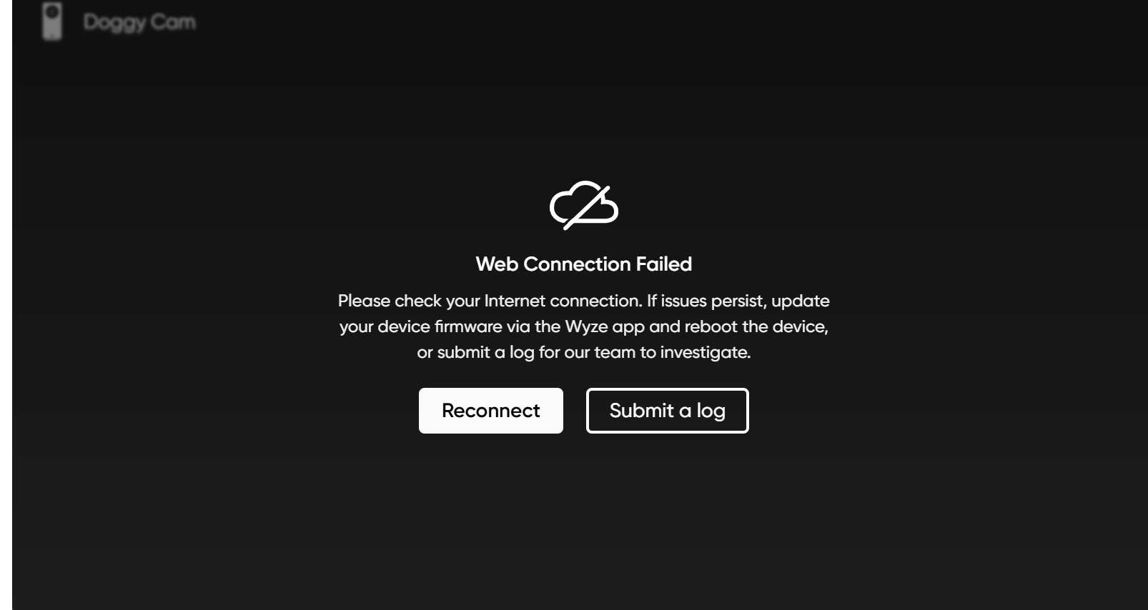

Stumbled across this thread and figured I’d add in. I believe I have a v1 camera. Its pretty old that I got from a buddy. It works in the Wyze Andriod application but fails on my GH or…and this is the best part…their own my.wyze web page. Short of deleting the camera from Wyze and readding it I have followed all the recommendations in this post. So odd.
Welcome to the Forum, @hyjnx! :wave:
Note the relevant Help Center article:
Wyze Web View is not available on Wyze Cam v1.
What kind of friend would give you a v1 camera?
V2 maybe.
I guess i was wrong, i checked the App it says Wyze Cam Pan.
Its a wyze cam pan. He was upgrading and offered it for free
In that case, great.
Welcome to the forum.
Okay, that’s a different animal. In that case, I’d suggest starting a new topic to get your issue proper attention. If I was creating it, I’d try categorizing it with Services & Integrations and tagging it with web-view and cam-pan-v1 (or whatever camera model/version it actually is).
I’d also post the firmware version that the camera is running and/or update the firmware if you haven’t already done that. I don’t know for sure if this is the case, but I would expect that Web View might require certain firmware features in order to work, and those features may not be available in older firmware versions. That’s just a guess on my part, though.
