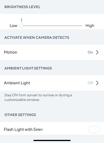

Can you check if you have ambient light enabled in the floodlight settings. Try disabling this.
Ambiet light is disabled.

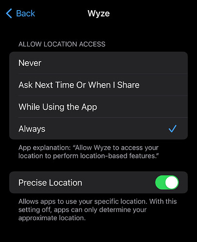

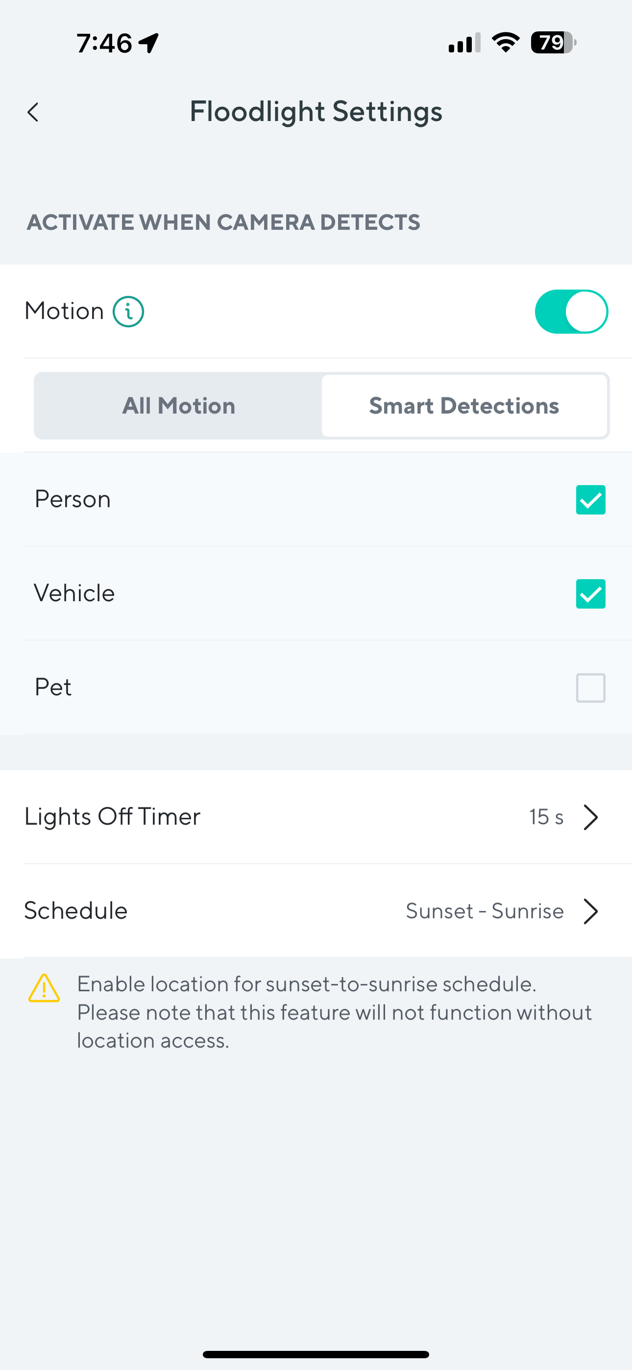

Please enable location for the wyze app in your OS settings. Thats the only way the camera knows what timezone your in and what time is dark. After that, try disabling the motion toggle for the floodlight and editing and resaving the schedule. If that still doesn’t work you may need to delete the device again and set it up.
Location services are turned on and Wyze app has location access.
