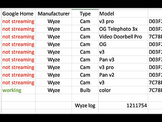

I submitted a Wyze support ticket for my cams. None of them are streaming. My Wyze plugs, bulbs, etc are all working fine. My Nestcams work fine. I have relinked, reset, rebooted, … and I am on current beta software on all devices.
Does anyone in :canada: Canada have Wyze cams streaming on Google Home?
@WyzeJasonJ
In Canada and working for me in Google Home… but I do not use it as it is PAINFULLY SLOW!! totally unusable as it is…
