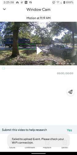

I’m getting Failed To Upload, check your WiFi on a couple of my events, they are person detection Cam+ events which makes me think they did upload. 95%+ of my events play back fine but a specific few error like this. Being person detection events I would think they are actually uploaded…?

So, I think all of the videos that I see this happen on are under 5 seconds.
Here are screenshots showing 2 instances.
All of the other videos worked/uploaded fine.

The camera is 6 foot from my router (orbi mesh - main router not satellite).
The recording is on my SD card (I have continuous recording enabled, so these events missing or not uploaded isn’t a big deal. I can still view them in playback). It’s a brand new Wyze branded SD card, if that matters.
I doubt it’s congestion, as I have approx 400 down and 40 up speeds.
What’s odd is its only on these short recordings. Doesn’t happen on recordings longer than that.
