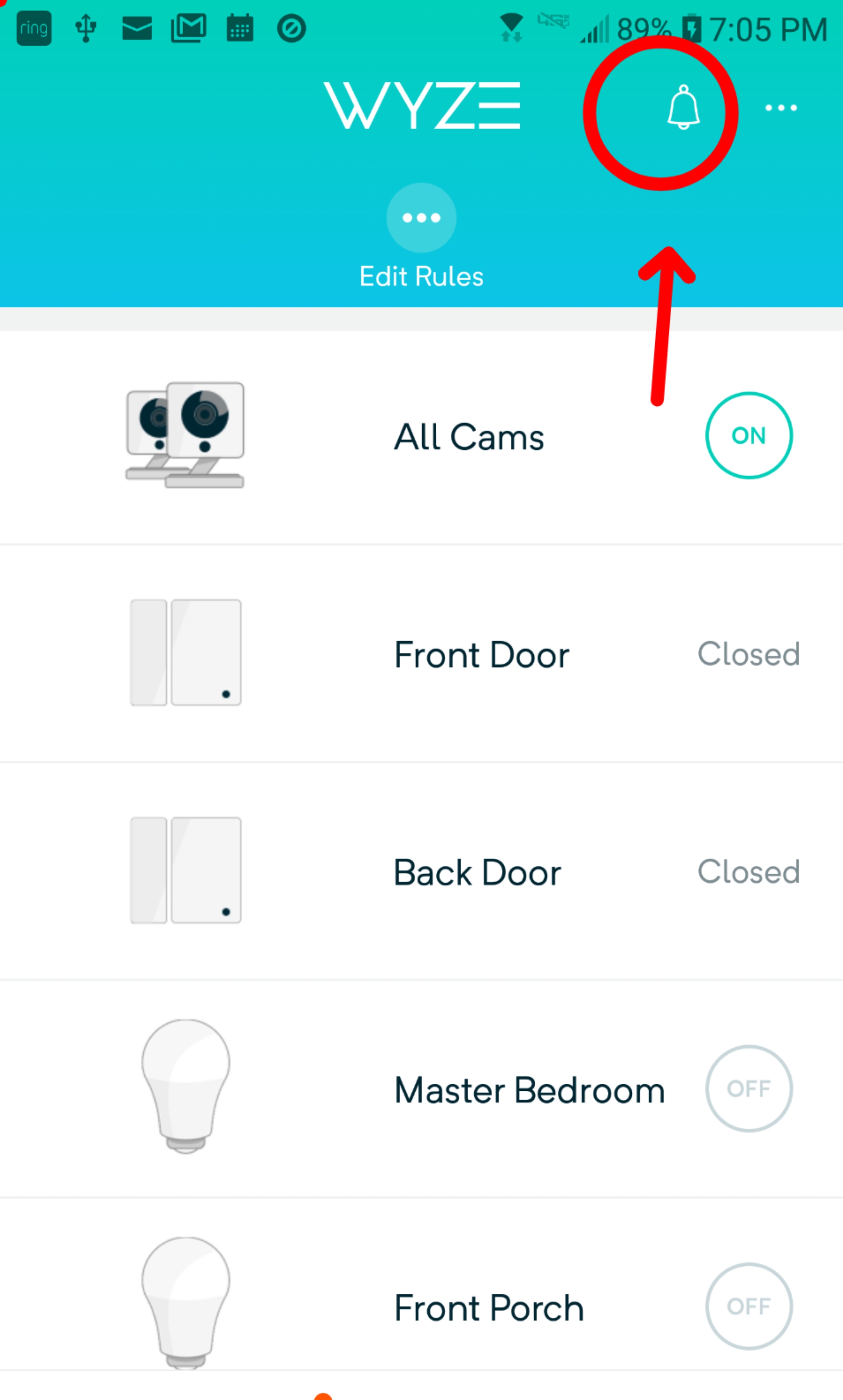

A few settings to check
Apologies, it will only let me post one picture per post, but looking at your pictures you just posted I have those exact settings enabled, but still no luck.

Can you screen shot your events page?
And after dealing with Wyze support, please update this thread with a resolution if one is found, thanks!
No error messages when accessing the events page, here’s a screenshot of what it looks like.
