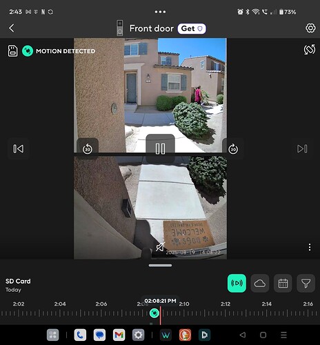

My duo doorbell cam is set to record video triggered by motion to my SD card, and it seems to. But when I review the SD card timeline it doesn’t actually show when video is recorded.
I can usually guess around when there is video based on when there is an alert, but that’s not always the case.
Example: if someone walks by
my doorbell at 2:08 there is a recording at 2:08 but the timeline doesn’t show me that there is video there.

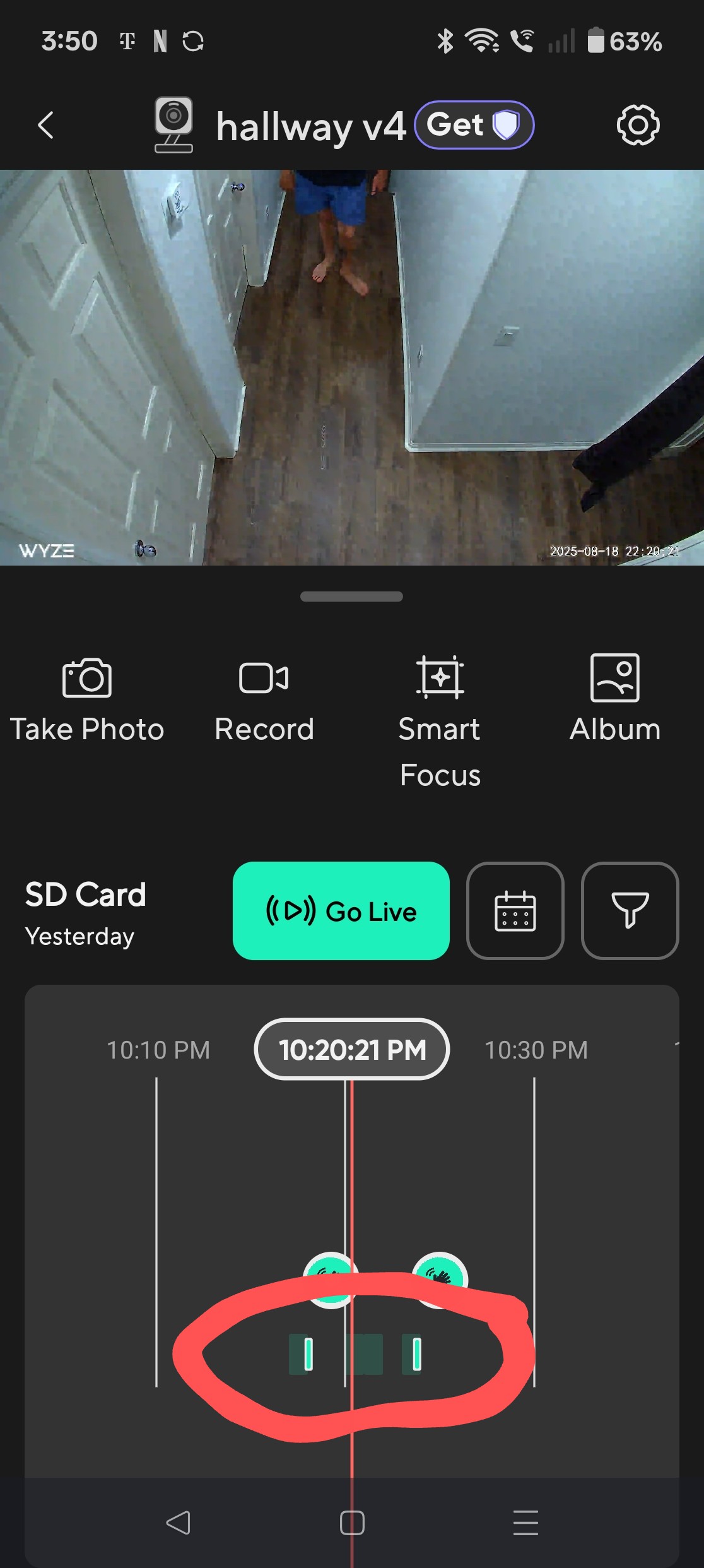

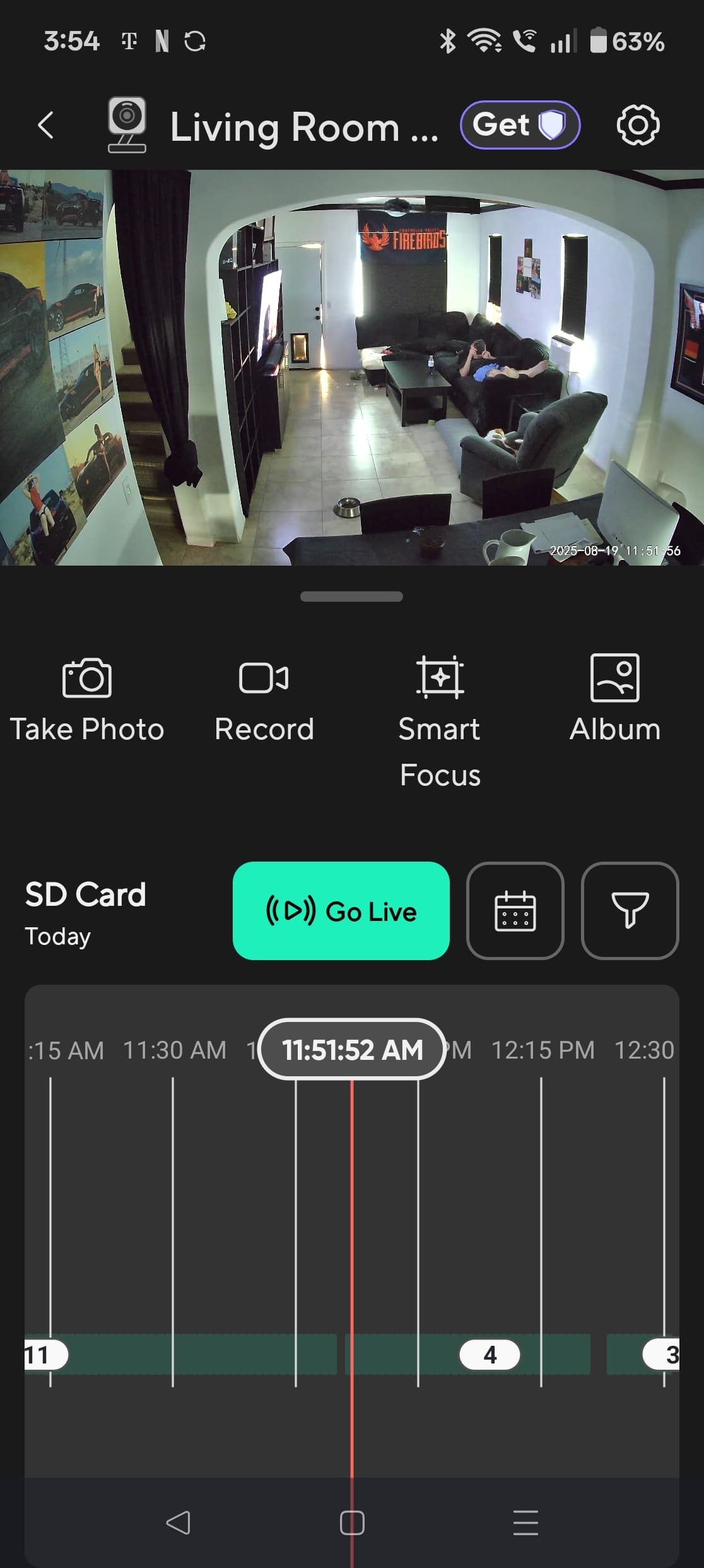

Yes, but my hallway and living room cameras actually shows me where I have video.

I do not own a Duo Cam Doorbell, but looking at the image in your initial post with some added arrows…
  • Red arrow: This little green element appears to be a fragment of the green strip that typically shows on a microSD recording timeline. With my other Wyze Cams set for Continuous microSD recording, I tend to see an unbroken green strip in the timeline. With yours set for event recording (at least that’s how I interpret your original description), I’d expect to see green boxes like this for recorded motion events and not a continuous green strip for the microSD recording timeline. I wonder if that’s the indicator you’re seeking.
  • Yellow arrow: Does the UI allow you to drag this bar upward in order to make more space for the timeline on the bottom, or can you only drag it downward to increase the view pane area? If you can drag it upward to enlarge the timeline, then maybe that would enlarge the green boxes for your events and make those easier to see? (I’m speculating.)
Also, with the UIs of other Wyze Cams it’s possible to use spread, pinch, and double-tap gestures on the timeline to zoom in and out. I wonder if doing that would be an option with this doorbell to help those green recording areas stand out. :man_shrugging:
red and yellow arrows to indicate UI elements
  • Red arrow: the video taken in my family room is also on a camera that is set to event recording. Once it detects motion it continues recording continuously until the motion stops.

I was responding to what seems to be your initial issue:
I believe that’s what the little green box is showing in your original image, and that’s what I tried to point out with the red arrow.
That little green box shows there was motion. But if you look at the redline, where I am viewing, it is showing me a video but the light green box to show where a video has been recorded is not there.
If you look at the pictures from my other cameras you can see there is video…that isn’t the case with the duo.
Ah, okay. With a still image I can’t tell that it’s actually video you’re seeing at the time of the pointer (the red line). I was getting the impression that the images above the timeline were stills leftover from the video before that time (indicated by the green box and the Motion event marker). If you’re actually seeing video at the time indicated where the red line (but no green box) is shown in the image, then I agree there’s a problem.
