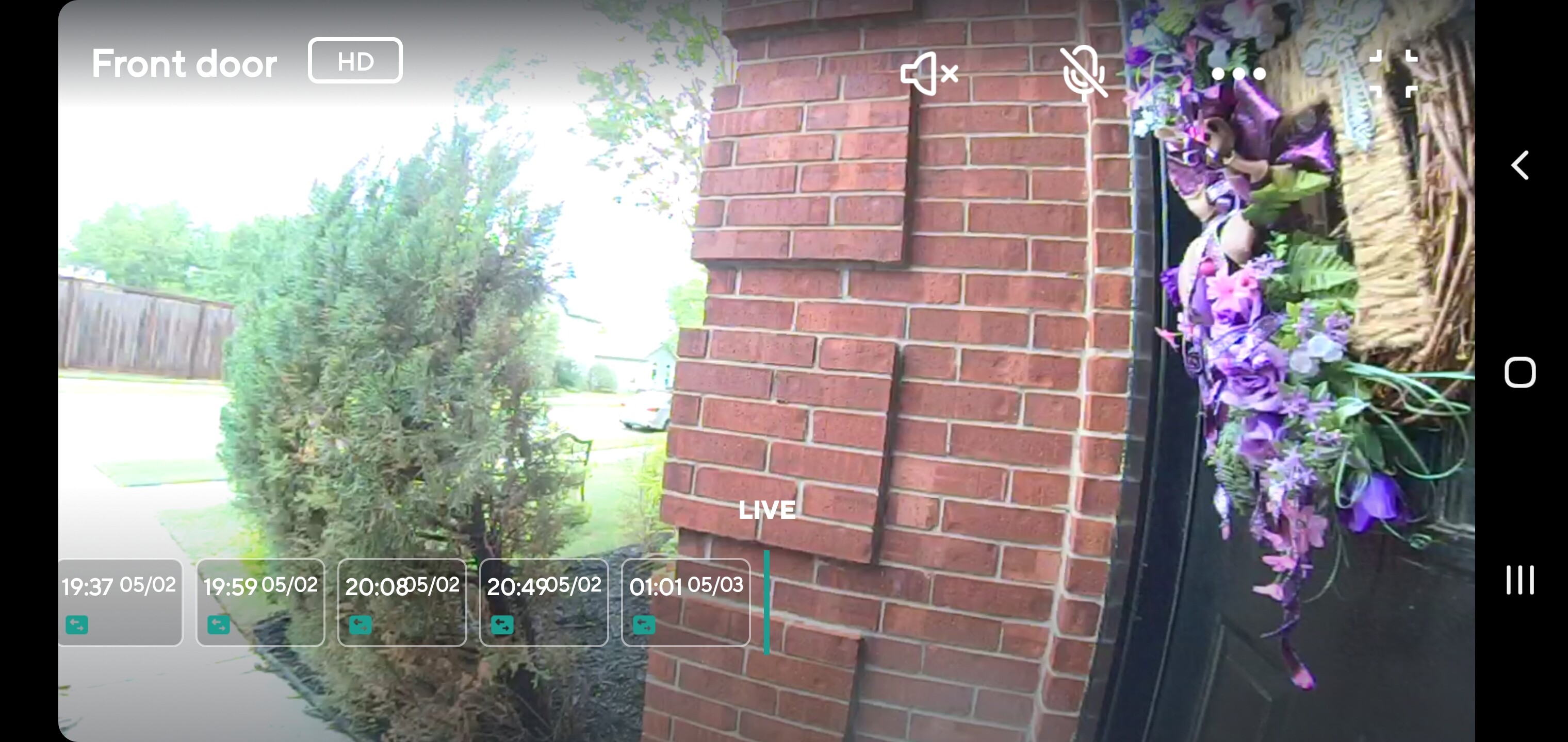

My video image from Doorbell Pro is hard to see when the sun is out. The shaded part on my porch is fine, but where the sun is shining, it almost looks like fog.
Can you send a screenshot? Is the sun shining directly into the camera, it could be caused by glare.
Yea, so since it looks fine on the right, im guessing its because the sun is shining right at it, washing out everything around it. I would suggest trying an angled mount to adjust its view, but thats really all you can do. any camera has this issue unfortunatly.

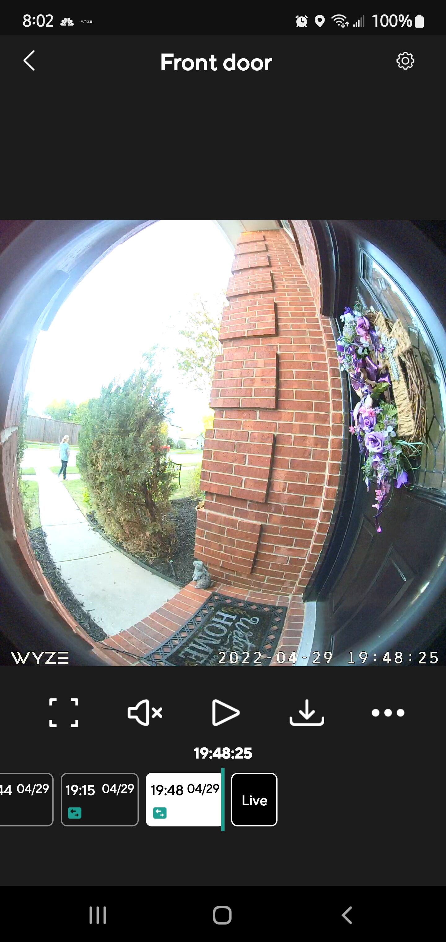

It is on a wedge and the sun doesn’t hit it. I attached a picture from a reviewer, the background is very sharp. Is there not a way to adjust the contrast? It’s sad that you can barely see the street. You can’t see the sky.
Does it always do this, or only a specific time of day?
Always
hmm, can you send me a picture of it later in the day, when the suns not right in front of it?
Not sure what tz your in, but could you try to get one when the sun is on the other side of your house, like maybe in the morning. Thanks
Hmm, thats strange. It looked like the sun, but if the suns on the other side I dont know why its so bright. Could be because of the diffrence is lighting on left and right, and it just chooses to adjust for the one on the right? Not sure what the fix for this could be…
Maybe if you angled it left a little more it would decide to adjust for the lighting on the left instead? Do you have any more wedges or anything to put it on?
No I don’t. It’s odd, the lighting is basically the same on both sides. No tree shadows close enough to be in camera range . You would think not facing the sun, it wouldn’t be a problem
These low cost cameras has very limited ROM space, so the Auto White Balance is Very basic.
You can try put a polarized filter len on to see if you can cut the glare.
I might try that. This is from this morning and it’s cloudy and dark enough where my neighbor’s lights are still on
