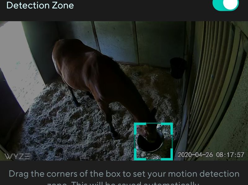

Just so I’m clear - the screenshot that follows shows the smallest zone I can create - folks want to create smaller rectangles than that?
(that is encompassing one our horse’s feed bowls in his stall, so a very small area)
If “yes”, I’d say it’s time to reposition the cam (?)
@myswtest your screenshot is a perfect example… What tablet / phone are you using to make it this size? On my android its 1/8 of screen size. I would be super happy if I had your ratio.

That screenshot was produced on my Samsung S10+ (phone) running Android 10 using WyzeBeta app (2.10.36) and firmware (let me check … 4.9.5.111 )

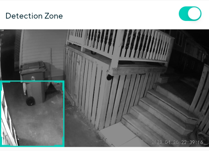

@myswtest here is a shot of the SMALLEST I can now make after the update. Before I could limit the zone just to my driveway. Now I have to have zone inside of my window (cam is in window) If you click on any cameras dectection zone it defaults to the new larger size. Thus reason I am leaving my other 10 alone! :slight_smile:
wow … that sucks.
