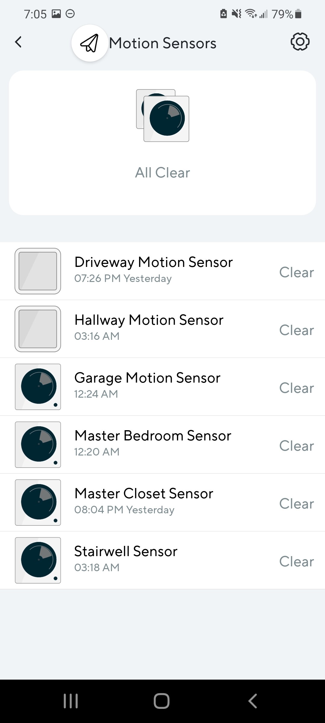

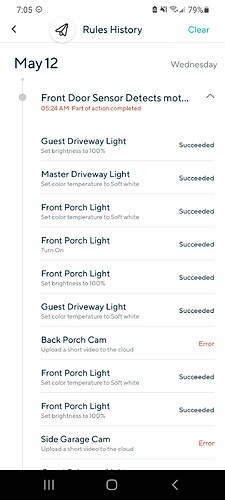

Old deleted rule associated with removed sensor still being run (Front Door Sensor was a v1 motion sensor I removed)
No more “Front Door Sensor”
It indeed ran, uploaded an event video and turned on the lights.

  3. When it happens, will you take a screenshot of your rules history (Account icon, Rules History)?
