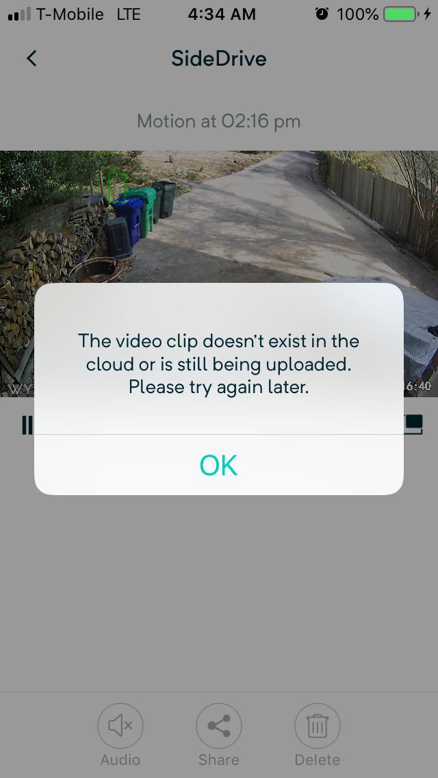

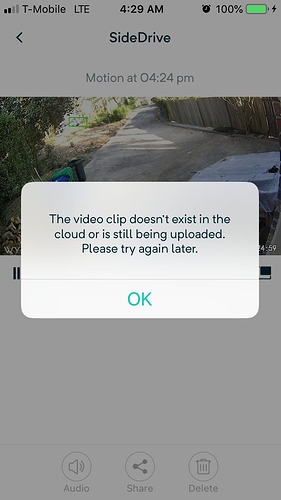

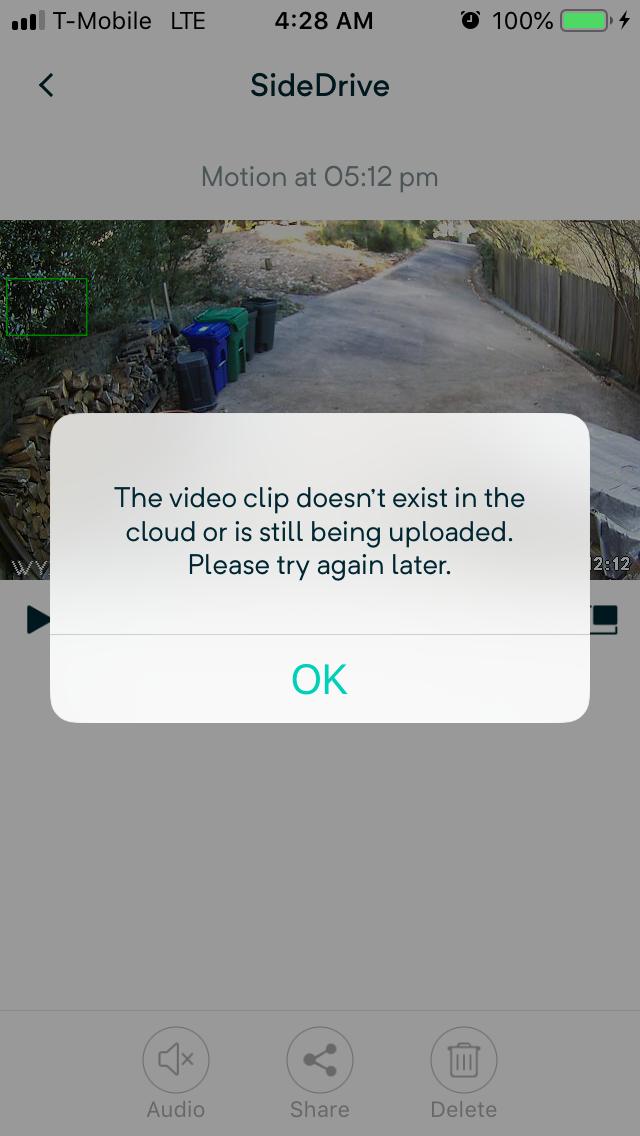

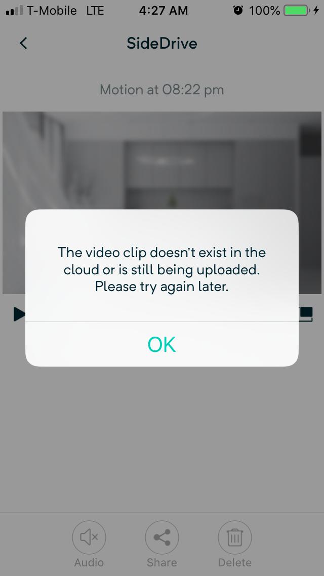

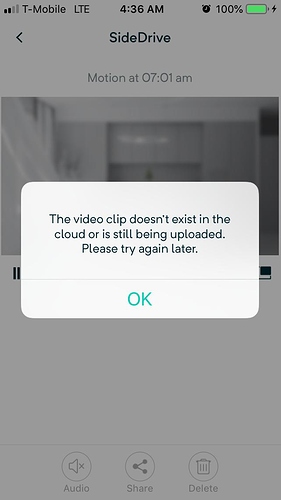

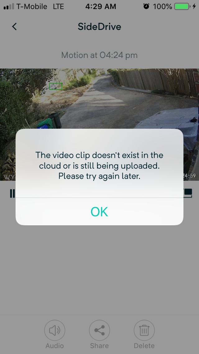

Yes, I did look for the video even without the push notification. Just looked again and still not there. Just noticed I have two Events from around 7AM that are listed in Events, both without thumbnails and one without a video.

Some of the weirdness in Events I’m seeing:
Seven minute delay, not that big but…
No thumbnail.
Thumbnail.
IMG_2391
No thumbnail.
Thumbnail.
Thumbnail.
Thumbnail.
No thumbnail.
A bigger question is what am I not getting.

Thank you for explaining the logic, that corrects a few of my incorrect assumptions. Yes, it is only one camera, which seemed to be working fine in its same location and on the same wifi extender the other 4 cameras are on. Suddenly, I started noticing connection issues and moved it to the main modem/router, which normally has better connectivity on my phone for the camera’s current location. Switching wifi didn’t seem to help and “This video doesn’t exist” errors even seemed to increase. Jan 29, I noticed several "video doesn’t exist” errors (screen grabs above) from overnight and the previous day (Jan 28). I started a trouble report from the app, included the logs and left it sitting in my email draft folder. That log should correspond to the listed errors. I’ve update that draft with the events and sent it including the log to the above address. QUESTION: If I include the log from Jan 29th, do you still need me to perform step 3?
