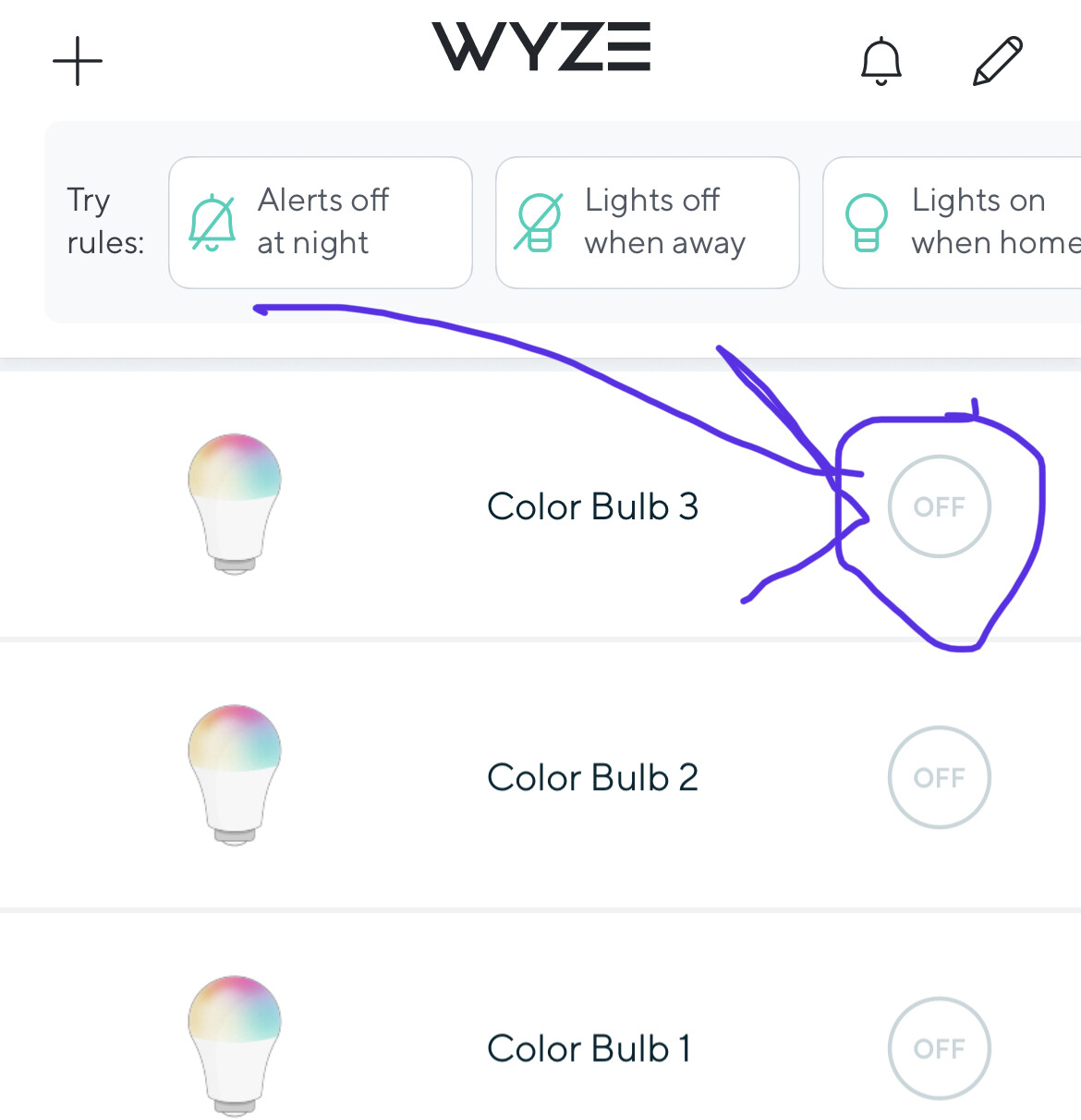

Just to mention this incase there is some confusion: by “turn the bulb off” it is not meant turn off power to the bulb by either flipping the switch to the socket it is plugged into or unplugging the power cord. “Turn off the bulb” means to set the bulb to an “off” state in the app. The bulb will still have power running to it (which it needs to run its Wi-Fi and get and process the update, but it will not be emitting any light. This is counter-intuitive portion of Wyze’s workflow as they have the bulb start emitting light during setup and then jump right into the firmware update.
Also there are 2 places where you can set the bulb to its off state: one is in the bulb’s control screen (where you can set color and intensity, etc.). But when a firmware is required you cannot use the power button on the screen because the update firmware overlay prevents it. So you’ll need to the “off” button on the main page of the Wyze app that lists all your Wyze devices
then tap the bulb to open it’s control without hitting the “on” button where you should then see the firmware update screen. Do the update, and that has been what is working for most.
