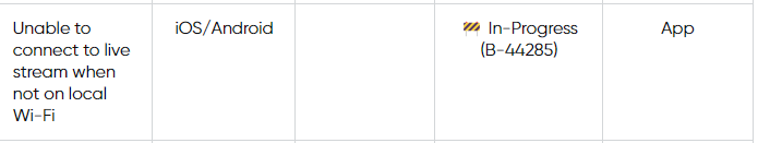

Alright I’ve confirmed this is definitely an ongoing issue for some people with certain camera models and that it is not affecting everybody for some reason. Frustrating!
The correct place to keep track of the status for this issue is here:
Go down to the section titled “Other Wyze Cam and Wyze Smart Home Known Issues” and open that up. In that section one of them will say this:
We can hope the issue will be fixed for people with the next app update whenever it launches. If I were experiencing this, I would personally consider enrolling in the beta program and seeing if the new beta app helps resolve the issue for me. Wyze has been saying that the new beta migrates a person’s account to a new backend system for some big services changes they are working on implementing. But be forewarned that it also says it will cause:
camera attaching will not be available until the public (non-beta) release of Wyze app 2.50.
