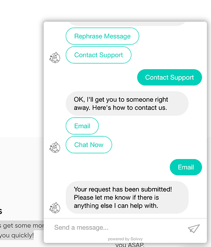

I filled out the support request but the chat dialog did not give me a ticket number. I used my account email address though so perhaps you can find me that way?
Screenshot attached.
