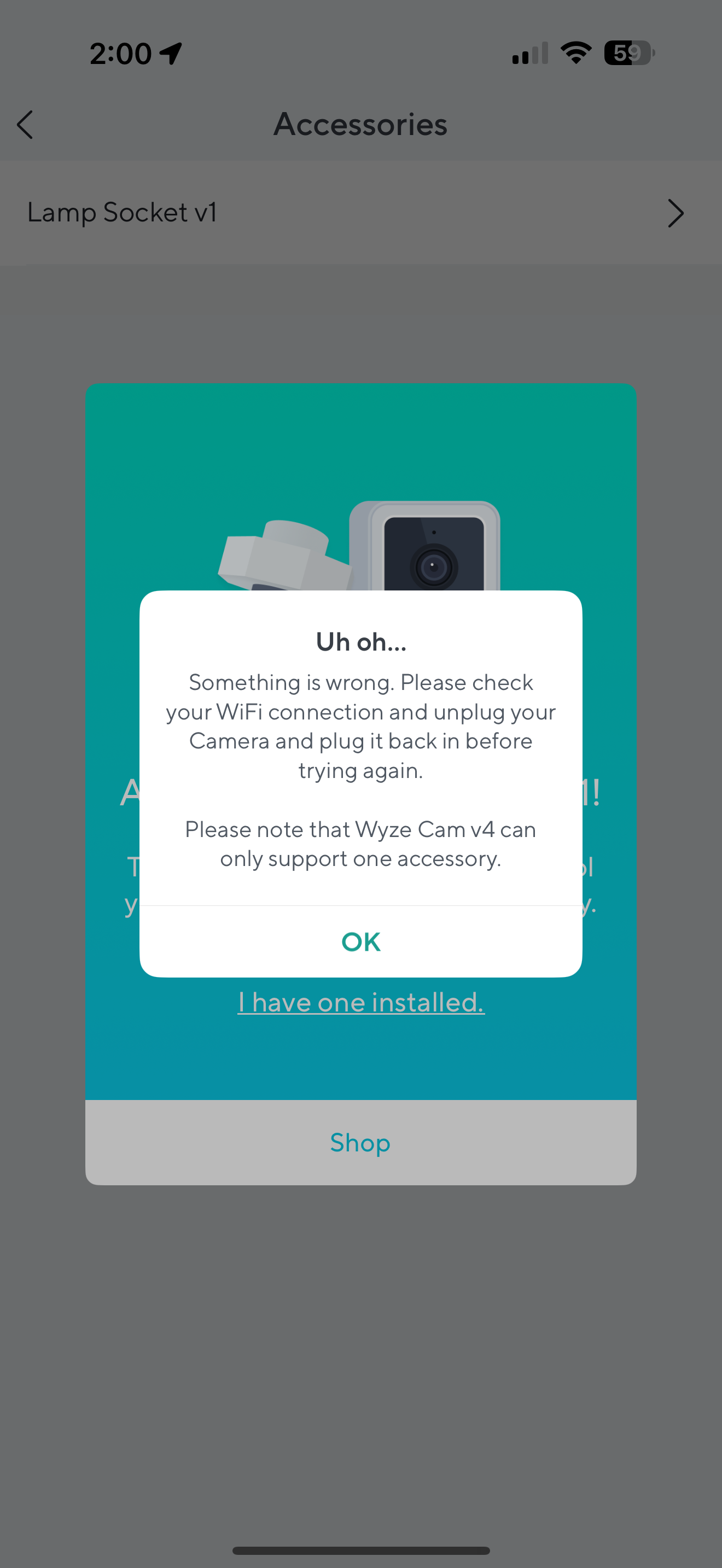

Cannot get my V4 to find the lamp socket after relocating the camera
I’ve tried every possible sequence, except one that works. had my V4 working fine with a new lamp socket, it hasn’t been working for about a month, decided to move the camera a few feet over to get a better angle of my back porch. When I plugged the camera back in and it came back up it suddenly had no idea it was plugged into and installed lamp socket that it had been working with happily for about a month.
I open the ticket and was walk through the steps but no matter what I do it won’t find it. They offered solution was to send me a replacement socket.
I think there’s a better chance that I will win tonight’s lottery then that replacement is going to work since I can’t seem to get this V4 to recognize it’s plugged into a socket :exploding_head:
Has anyone had an issue reconnecting a V4 camera to a lamp socket after it has been working perfectly for a while?
I believe there’s some sequence I must go through, turning off the light socket deleting the camera from the app starting from scratch. But every sequence I have tried fails.
This is what I see, and I see it in my dreams at night :disguised_face:

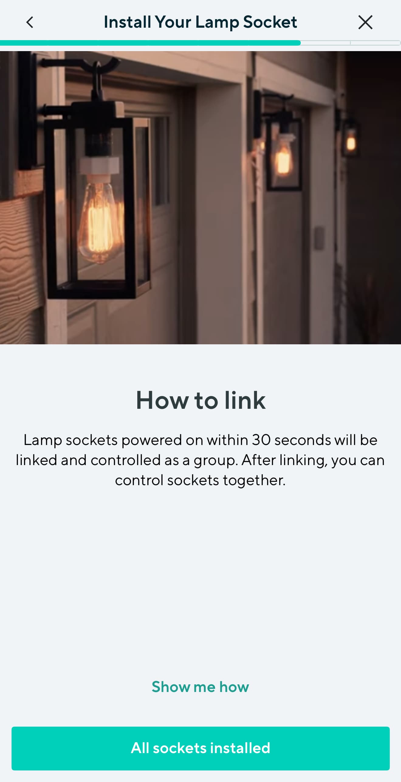

My understanding is that these actually do use BLE to communicate with one another so that if you have a Cam v4 connected via the proper cable to a Lamp Socket but then also have other Lamp Sockets within range (say lights on either side of a garage door), then all those Lamp Sockets link up to form a group. Then when your Cam v4 triggers the Lamp Socket that it’s wired to, the other Lamp Sockets turn on their lights, as well.
They should remove the reference to “802.11 b/g/n” from the product page. (I’ll add that to my list of things to tell them.) The Quick Start Guide properly (I believe) indicates that Lamp Socket uses BLE.
??? The other lamp sockets do not have to be plugged into anything? Just screwed in for AC power?
I assume this has to be accomplished when you first set them up, because there doesn’t seem to be any way to add more once it’s configured.

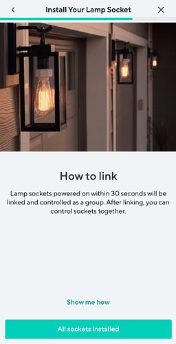

That’s my understanding. Read the product page and relevant Help Center section. This is from the product page’s FAQ:
How do I link multiple lamp sockets together?
Turn them all on (up to 5) within 30 seconds and they will find themselves, link, and form a group. Once they form a group, you can control each lamp socket in the group at the same time.

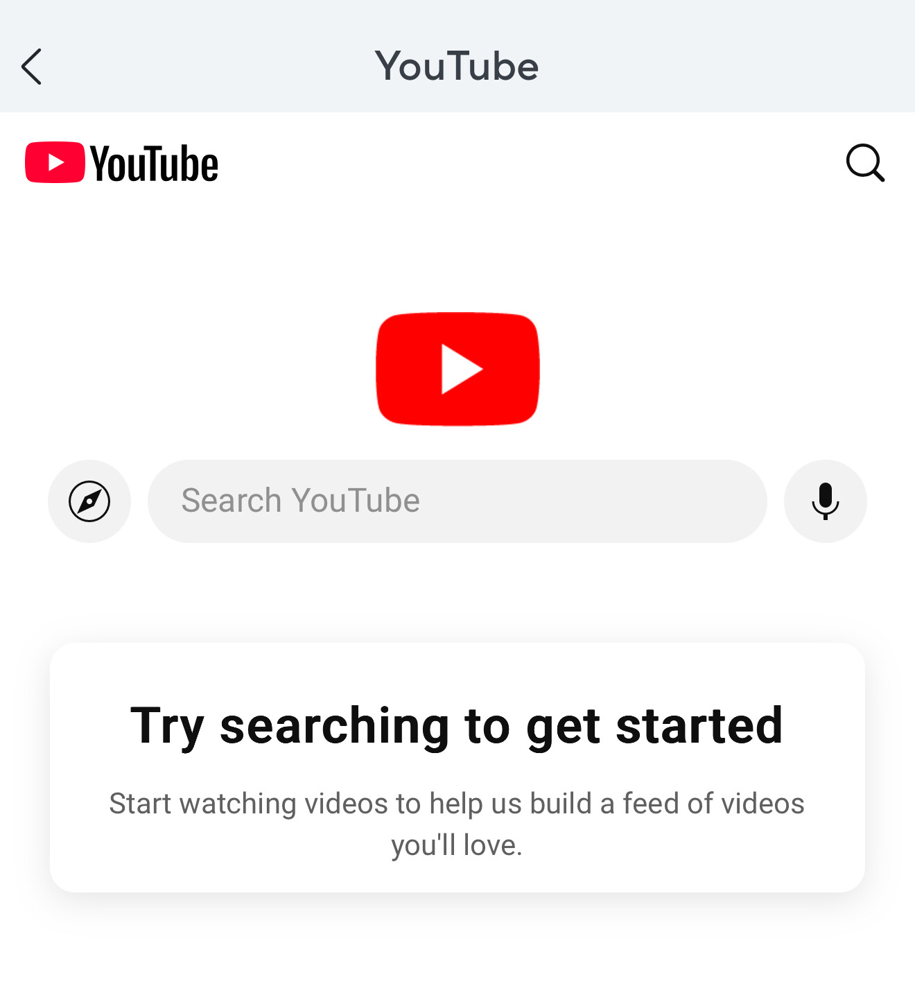

That’s when you go to the wizard, and ask how to set them up, it takes you off into a tangent somewhere that goes nowhere. If you follow the set up instructions where it says I have more sockets this is where it goes, again really nowhere.
I clicked on the show me how link it takes me to a generic blank YouTube page
Oh, gotcha. That’s unhelpful and should be reported. That’s something they need to fix in the app if it’s a bad link. I suggest logging it, opening a ticket, and then sending them the Log ID and any relevant screenshots. You can even link to this Forum topic once you have an active ticket, because at least this provides some additional context for the problem. This is something that should be passed along to the developers so they can fix it in the app.
