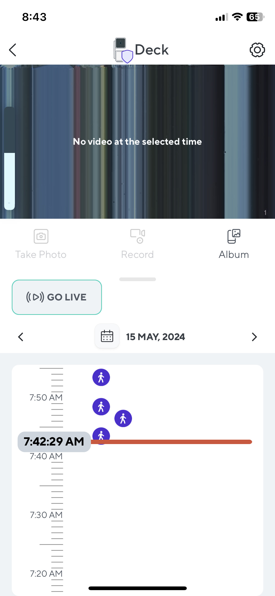

This attached picture shows what I am now seeing when trying to use the SD card portion of my pan cam v3 .
I’m going to go with it’s a bad SD card . I’ll replace it and if the same thing happens then the camera is just junk .

The screen shots make me wonder what your live view with that camera looks like. If that’s normal, then I think you’re correct with this:
That’s when I’d wonder when this happened:
…because that would make me curious about whether or not you might be eligible for a warranty replacement. (I haven’t seen any indication of when you purchased the camera and card nor when this problem started, so those are still unknowns here.) In that case, I’d also wonder if you’ve opened a Support ticket with Wyze, because sometimes I’ve seen a Moderator jump in and help someone out when they’re not getting anywhere with the official Wyze Support—and two Moderators have already posted in this topic—but they typically seem to want a Support ticket number as a reference point.

I noticed you bought a 128GB Wyze microSD card, but the app is showing you have a 32GB card inserted. Did you insert the 128GB card into the Cam Pan V3? If you did then I think your microSD is corrupted. Try formatting your microSD on the camera. If that doesn’t work then it is ideal to take out the microSD card and format it on your PC or phone.
In my experience, corrupted micro SD usually happens due to insufficient power to the camera like voltage dropping too low when using very long USB cables or defective power adapter. Another scenario where this happens is power surge / power outage causing the camera to corrupt the recordings and the internal controller locking it up from further writes to the SD card.
On the topic of micro SD cards with continuous recording, I tend to buy 128GB High Endurance cards from SanDisk / Samsung as they have more rewrite cycles. In general, higher capacity microSD cards will have more rewrite cycles in the Wyze camera as it takes longer to fill up and also they tend to use higher quality flash NAND. Overall, they are a little bit more expensive, but so far they have been holding on pretty well since 2021. One thing to keep in mind is that SanDisk and Samsung are two of the most counterfeited brands so you will need to pay attention who the seller is and who is fulfilling it if you buy from Amazon.
