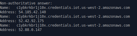

Sorry to resurrect an old thread, but I did actually find an update to the silly network flooding issue that was going on in the camera. I did some packet sniffing on my network and discovered that the following URL:
c1ybkrkbr1j10x.credentials.iot.us-west-2.amazonaws.com
This server I noticed seems to be some type of aws authentication server for the camera. The best way to stop the flooding I found was to set below to your routers dns of choice. You can do this in your routers dnsmasq
54.185.42.140 c1ybkrkbr1j10x.credentials.iot.us-west-2.amazonaws.com

No problem! Note that 3 ips actually respond to that address:
they seem to have a round robin DNS response of sorts. I find it best to edit the hosts file of your device possibly based on the result of an nslookup…how do we get someone from the wyze team to take a look at this thread? Id love them to see and maybe know what to patch in firmware so other folks (average users especially) are not being bugged by this. Its fine for people like myself to hunt and find this but people who are not as knowledgeable should not be tasked with this type of fix…

Based on the research ive done, the AWS host listed here is infact some type of credential endpoint. Being an AWS server is no surprise to me. Wyze uses AWS on their backend. In mine ive mainly traced connections between AWS, OVH, Akamai (which isnt a bad thing).
The dns entry I gave is not a black hole at all. If you look at my screenshot, There are three servers in a round robin configuration that respond to that address. The constant I found in the flood condition seems to be that the camera believes it lost connectivity to that service for whatever reason and proceeds to flood my cellphone carriers dns server with requests on port 10001 for it. This simply gives the camera what it wants so its always happy.
