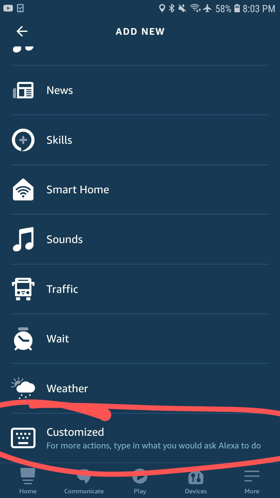

To do this use the “Customized” option at the very bottom and enter the command “show (cam name) on (device name)”
The “customized” basically does whatever phrase you input as if you actually spoke it out loud without actually having to say it.

Dude, you’re a genius! It totally works! No announcement necessary, go straight to streaming the cam on any Alexa Device without a verbal command! This is awesome!
  1. Set up an Alexa Routine using the “Person Detection” Trigger of the Wyze Cam in question.
  2. Set the Routine Action using the “Customized” action, and just tell it “Show [Cam name]” (alternatively you can tell it which device to show it on if you want, but this isn’t always necessary).
  3. Set the Device/From/Respond From section at the bottom of the routine to be the device you want it to show on (I set it as my Office Display for example).
