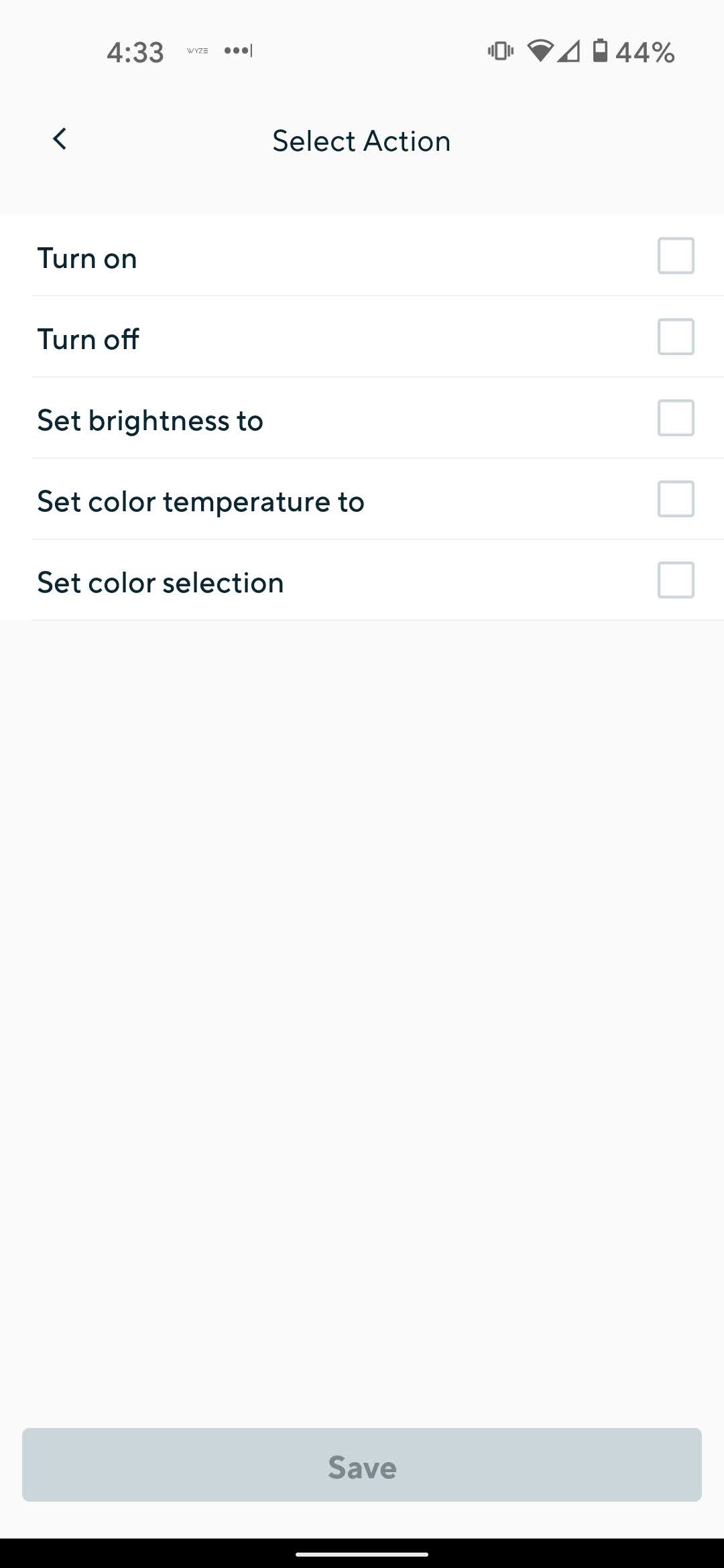

Just saw that the new Rules Engine allows setting the Color of the Color Bulb.

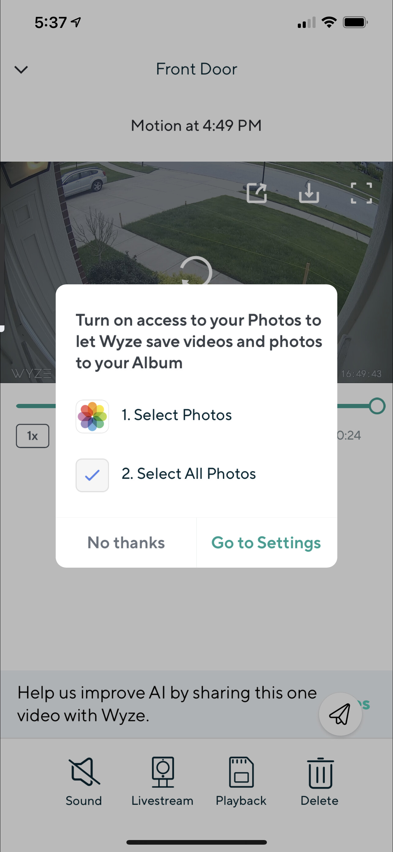

Can you Beta testers try something out with the iOS app. you are playing with. Prior to the iOS app 2.20.142 when you downloaded an event video from the V3 or other cam you had the choice to give WYZE permission to access “Selected Photos” or all photos on the iOS device, that no longer works. You can download only if you give access to “All Photos” which seems very strange to me. The good part with the new app (2.20.142) is you can now download 1080 HD videos.

Looks like it is all photos… I tried selected photos, then tried to create a new WYZE folder and it wouldn’t download until I selected all.

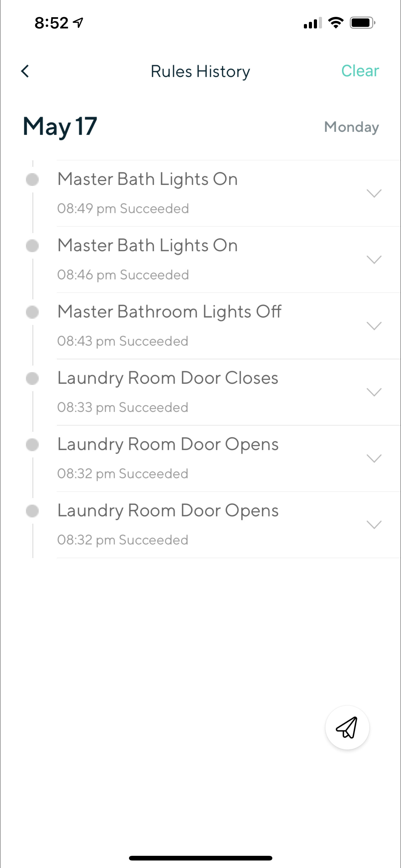

Test results:
Test 1
Tested a couple legacy rules since I am in the test group now.
These rules are set to turn on WYZE bulbs (non-color) when a door opens using a V1 contact sensor connected to a V1 hub attached to a V2 camera.
The response was much faster… on average 2 seconds, where before they would take 3-4
Test 2
Deleted and built a new rule using a V1 motion sensor connected to the new Sense hub, where if the sensor detects motion to turn lights on, then turn off after 20 minutes of the room being clear.
All tests successfully executed so far. I have built a new one I will test later.
