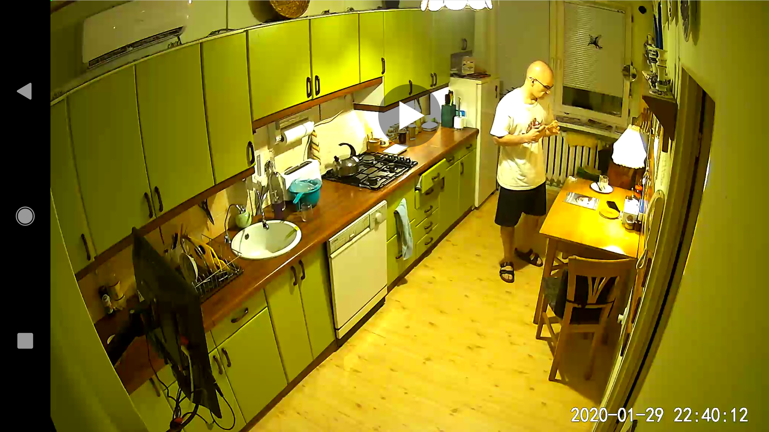

Hi,
Anyone else experiencing this? The only difference between the attached two screenshots is the firmware version. All the lighting, wall color, furniture, etc., is identical.
I have 2 cams pointing in front of my house. Right after the last week update, I could see a lot of yellow on these 2 cams. On the pictures, you can see one of my V2 pointing on the driveway. Check the time between them. One before the update and one after.
