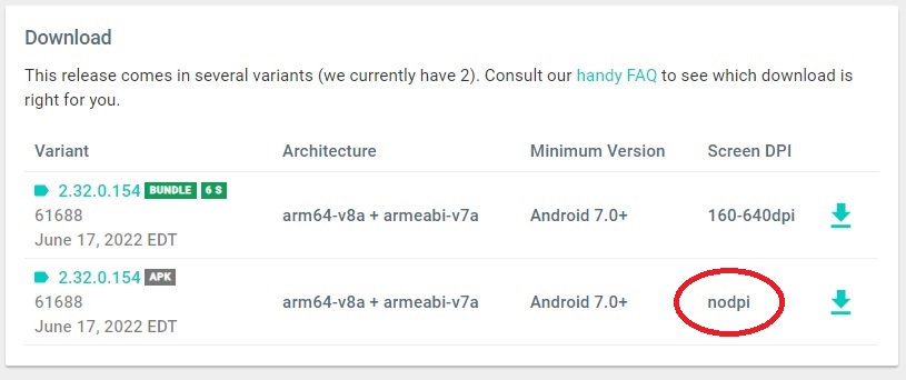

Great tip, @carverofchoice ! I did all of that, but no matter what APK version I download, when I try to open the download, it gives me a Parse Error (there was a problem parsing the package). Any tips on how to overcome?
If you are sideloading, make sure you are downloading the nodpi version for your tablet.
Yes, I did use that version, and I tried several earlier versions, same parsing issue every time.
What device are your tying to install on and what operating system and version?
