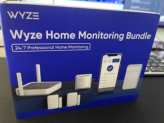

I did order a Starter Kit to have a backup to test against.
That’s great idea! :smiley: I think I’ll do the same today! :+1: That would make everyone else happy. I’m driving them nuts with chimes and alarms going off all night. :rofl: A separate test HMS will restrict noise to my office.
Like you, my wife is going crazy. Thankfully I could still control the lights and items outside of the sensors triggering them. But, this has been driving me crazy as well.
I just did the same. Ordered a second kit. My plan is to separate what I use for HMS and what I use for automation.
Happy to beta with the WSH dedicated to sensors used for purely Automation, will leave the WSH associated to Home Monitoring Sensors on production release firmware :wink:

On a separate note, the secondary Wyze Sense Kit I ordered yesterday… arrived today :astonished: :exploding_head: That’s some fast shipping!

I did setup my secondary WSH (for automation/testing and not associated to the HMS system) and added a number of sensors. All working well. This device is on the original firmware 4.32.2.123, and for what it is worth. There is a clear difference in the High Volume between the two.
