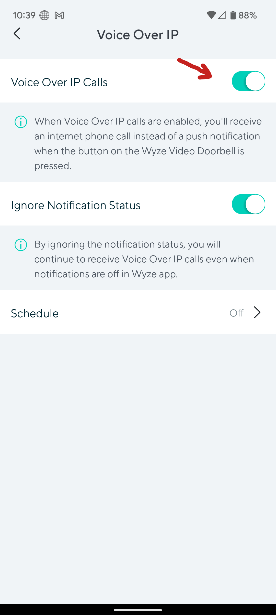

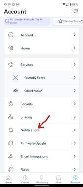

I use the VoIP Process which actually calls your phone and will connect you to the doorbell if you answer it. Works really well.
Go here to turn it on as I believe it is available to all:
  • Start your App
  • Go to Account (Bottom Right Menu)
  • Go to Notifications
  • Select Push Notifications
  • You should see Voice Over IP as an Option, select that
  • Turn it on and back out.
Now when your doorbell is pressed, your phone will ring like a phone call. Here are some images:
