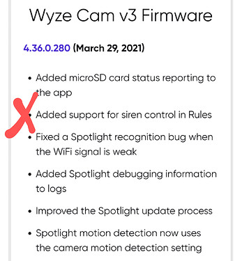

My V3 camera will not turn on siren with a rule for when motion is detected on the V3. I tried a rule for my Wyze lock to turn on V3 siren when it is unlocked and that won’t work either but a rule for the lock to turn on the Wyze bulb when unlocked works. I’ve tried other V2 cameras with a rule to turn on V3 camera siren when motion is detected but no luck. Siren works within the app. Any thoughts?
Same situation here. The i-device people don’t seem to be having issues with the siren (Wyze v3 sound alarm when human detected at specific time interval), so this appears to be an Android app problem. Using version 2.17.7 of the app.
Tested all setup options and the siren on my V3 camera will not turn on from any device trigger. I can turn on my Wyze light bulb from the V3 camera when it detects motion so the issue is not the app or the V3 camera but the camera firmware is not setup to do it. Maybe Wyze didn’t program it to be able to so they can have it trigger the spotlight to turn on with motion detection that they are now selling for the V3 camera?
Same problem with mine.
I have the same problem. It is not working. I tried it on two different V3 camera - no luck. I would like to hear from Wyze support.
Have you updated to the latest firmware from today on the v3?
I did update but I already had 4.36.0.280 installed what updated today is 4.36.0.290!
