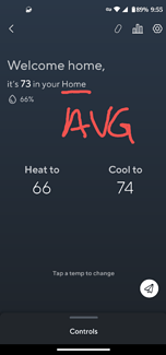

One of the ways I learned to determine if the App was showing me the Thermostat room temp or the Average temp of both Thermostat room and Remote Sensor room was to look to see what the App display was telling me:
My thermostat is named “Wyze Thermostat” in the app:
Screenshot_20220926-215440-715
The images provided by @SlabSlayer are from the App and not the actual T-Stat screen. The T-Stat screen will show the temp at that location and not the average in the home.
If it says “Home” the app is showing you the average of the temps of the 1) room the T-stat is in and 2) rooms of all included sensors.
If it says the name of the thermostat, it is ONLY showing you the room the thermostat is in and should match the unit display.
KEY here: Don’t name your thermostat Home!
Yes. As @spamoni stated… This is ONLY the app. The wall unit showing “Home” is it’s state (Home\Away\Sleep)
True, my is named Hallway as it is in the hallway. :slight_smile:
If you want it to be consistent, at all times, turn off the Motion Sensing Comfort, this will always use the Remote sensor in all schedules you have set. Currently it looks like you are using Home and Night to include the Remote sensor.
It is showing that because you have included the room sensor in both Home and Night mode. Plus you have it set to be included when there is motion. So no motion for about 30 minutes (I believe) will remove it from the average formula.
