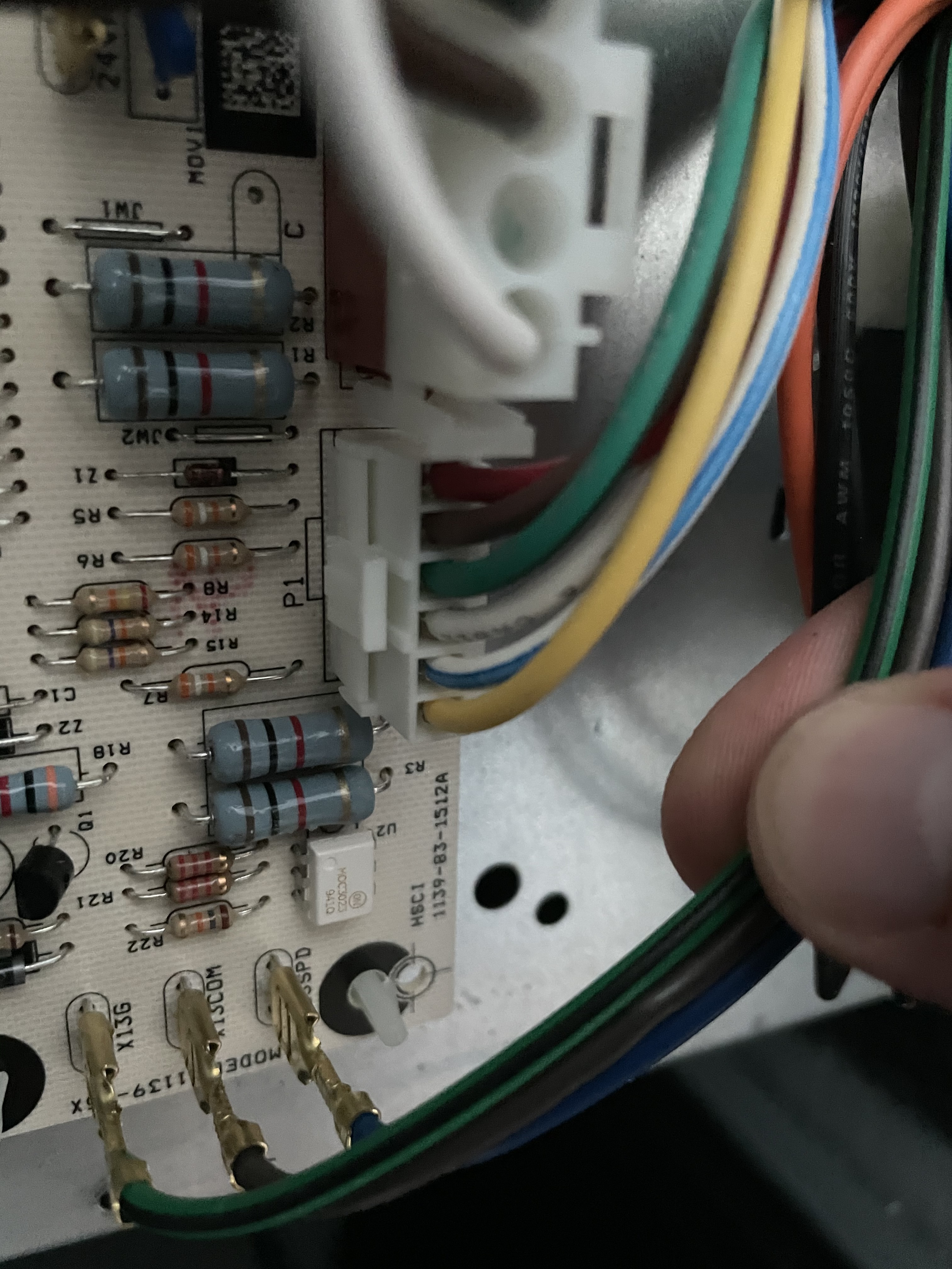

Show your air handler board wiring.
We need to see how your wires coming from the thermostat are connected to the terminals on the air handler side :slight_smile: These diagrams are nice, but they don’t help when trying to troubleshoot :slight_smile:
Sorry my bad:
All those are from the unit on 2nd floor
Look like both White wires W1 and W2 from P1 are being “breached” into one white cable.

You have 2 thermostats attached to one unit? What does the wiring for the non-wyze one look like?
It looks like the brown wire you have in the W1 terminal just goes back to the other thermostat, unless you have a heat pump and not another thermostat wired in parallel.
Show pictures of your outdoor unit if you’re not sure if it is a heat pump, otherwise if you do have a heat pump, your W1 wire is actually an O/B wire and you need to reset your wyze and re-add it, going through setup again and telling it you have the following wires:

I’d be willing to bet the brown wire should be an O/B wire, from the way the air handler is wired and the stickers on this unit. Try resetting your wyze by holding down the button and removing it from the app and re- adding it, telling it your “old thermostat” has the wires as listed in my other post.
During testing, the heat and cool functions might be reversed, just go into settings>advanced>swap heat and cool to fix it.
