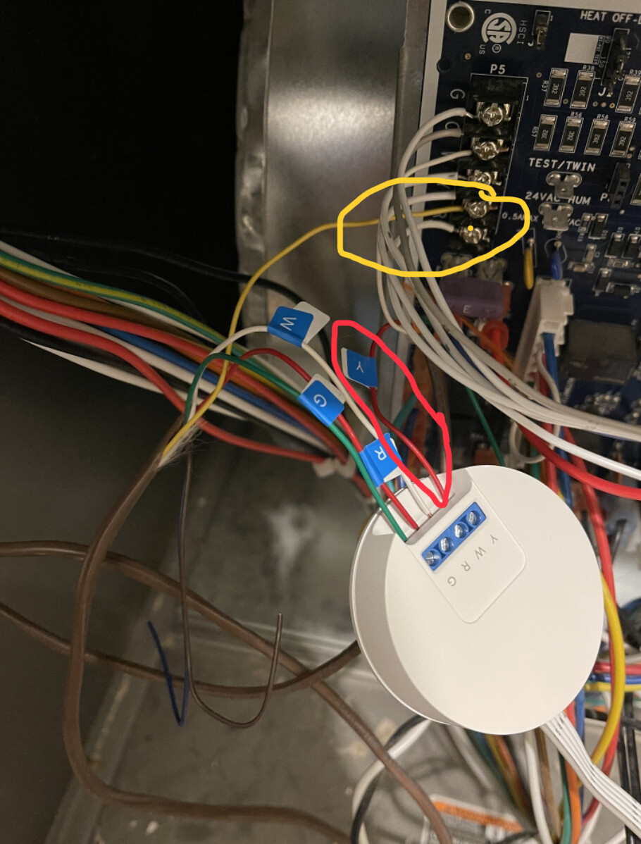

Pictures attached to show my wiring. All wires going into the C-wire Adapter are coming from the Thermostat except for the red Y wire, which is coming from the AC unit outside. The white wire coming from outside is attached to the C portion on the control panel and The green wire from outside is unused.
The cable from the Thermostat also has a blue and brown wire that are both unused and not attached to either the thermostat nor the control panel or adapter.
I tried swapping the red Y wire from outside and put it on the control panel instead and moved the yellow Y wire from the Thermostat onto the C-Adapter, but then the thermostat would not turn on altogether, so I put it back how it was.
Thoughts?

Where is the red Y wire coming from? What does the yellow wire coming from the thermostat do?
The red “Y” wire that comes from the A/C unit outside needs to be connected directly to the air handler’s control board, at the Y terminal, along with the other wire that comes from the outside that looks like it’s still connected at the C-terminal, which is where it’s supposed to be.
The yellow wire that comes from the bundle with W, G and R wires that are connected to the C-adapter needs to be connected to the C-adapter as well, to the Y terminal.

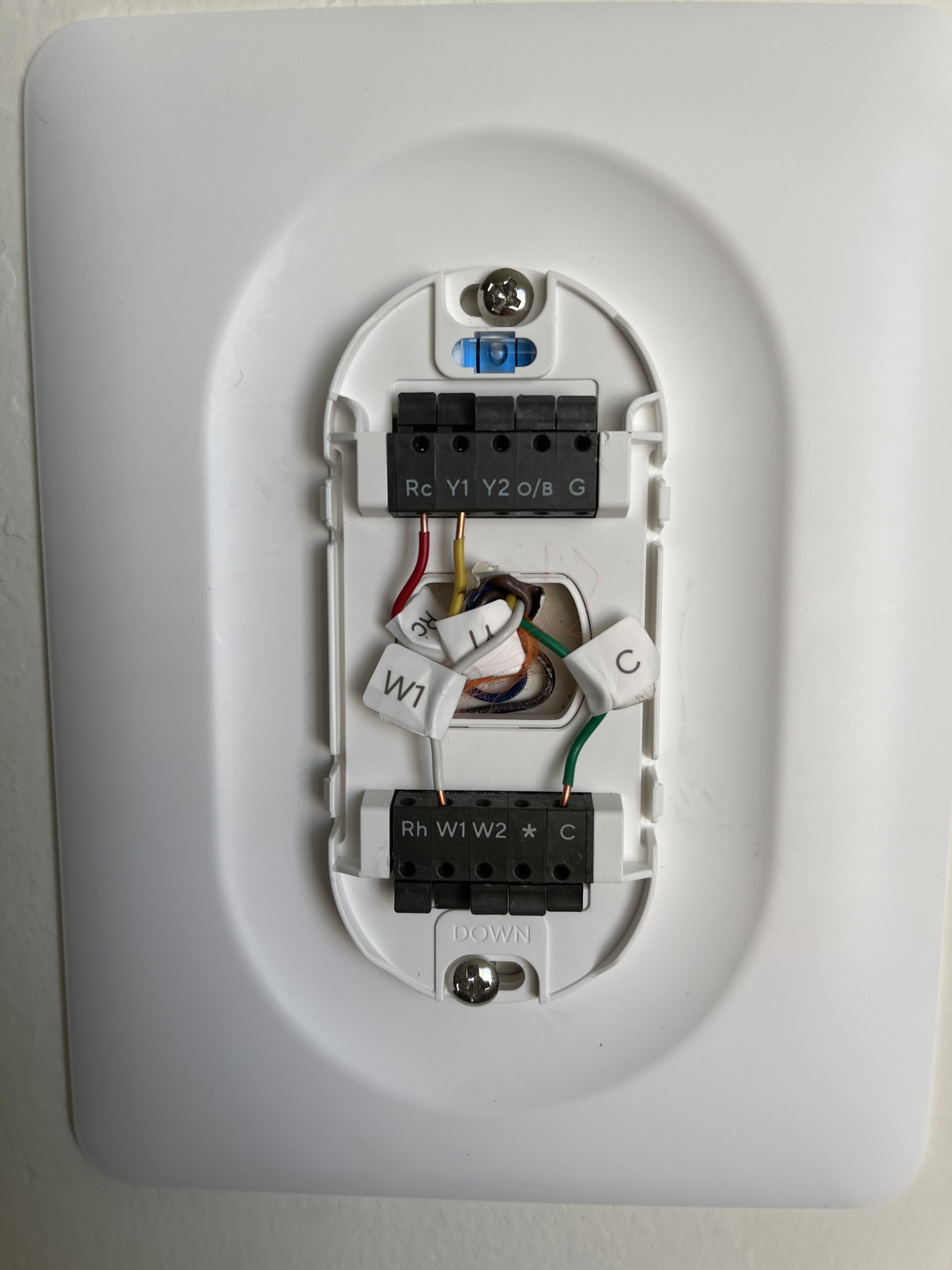

If you have a blue wire in that same bundle that is unconnected both at the thermostat and at the air handler side, you can connect it to the C-terminal at either end (Wyze Thermostat and air handler) and you won’t need the C-adapter.
Edit: I do see a blue wire on the thermostat side. If you move the green G wire on the thermostat to the G terminal there and connect the blue wire to C, and then connect the blue wire on the other end to the C-terminal on the air handler, you won’t need the adapter. You can just connect G to G, R to R, W to W and then you will have a yellow (from the thermostat) and a red (from the A/C unit outside) wire to Y on the air handler, and a blue (from the thermostat) and a grey/white/cream (difficult to determine for me, but the other wire from the A/C unit outside) to the C on the air handler. That should work :slight_smile:
Yep! That solved it. Made sure the Y from the Thermostat cable was on the adapter and the AC unit one on the control panel. Running like a dream now. Thank you!!!

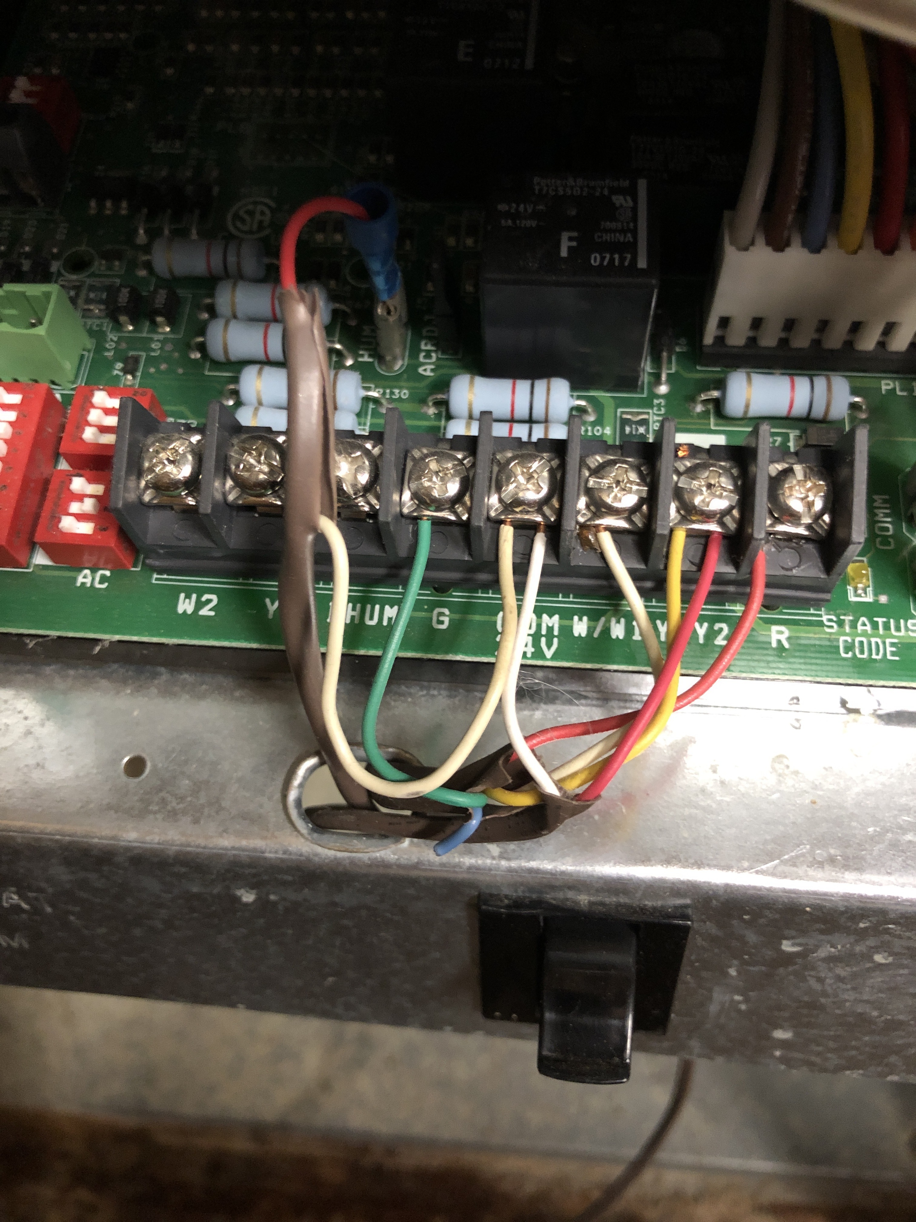

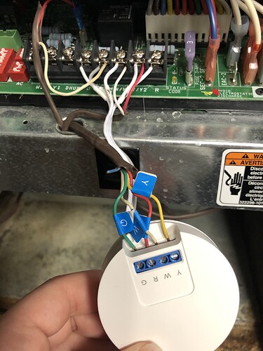

I am having the same issue, can anyone offer a suggestion? I assuming I just made an error in the wiring.
Before picture for reference
Do you see the red/white wires that come out of the same bundle? They come from the A/C unit outside. After connecting the adapter, you connected the white one from those two to the W terminal, but it should be connected to the COM terminal.
It also looks like you swapped the Y and W wires that come from the adapter and go to the furnace terminals, based on what I see on those white wires.
I do see the short blue wire coming out of the other bundle of wires. If you have that blue one peep out at the thermostat side, you can connect them to COM at the furnace here and to the C at the thermostat and you wouldn’t need the adapter. Of course you’d have to connect the current G-wire, that functions as the C-wire with the adapter, back to the G terminal on the thermostat side, but it would make things easier in the end :slight_smile:
There is no “open” spot on COM, it already has the gray from the adapter and then the cream from the other bundle. Should I remove one of those?
You can have as many wires attached to Com as you want, it is the common wire.
As vincent said, you swapped the Y and W wires from the C adapter, and you moved the white wire from the red/white pair that was attached to C to the W terminal. You must put each wire on the correct terminal or it will not work.
What @speadie says :slight_smile: There is no real limit to the amount of wires you can attach to a terminal. Just unscrew to the point that you can fit all three under the little metal plate and tighten back up, that will work. Just make sure all wires are securely connected.
Worked like a charm, thank you both!!
