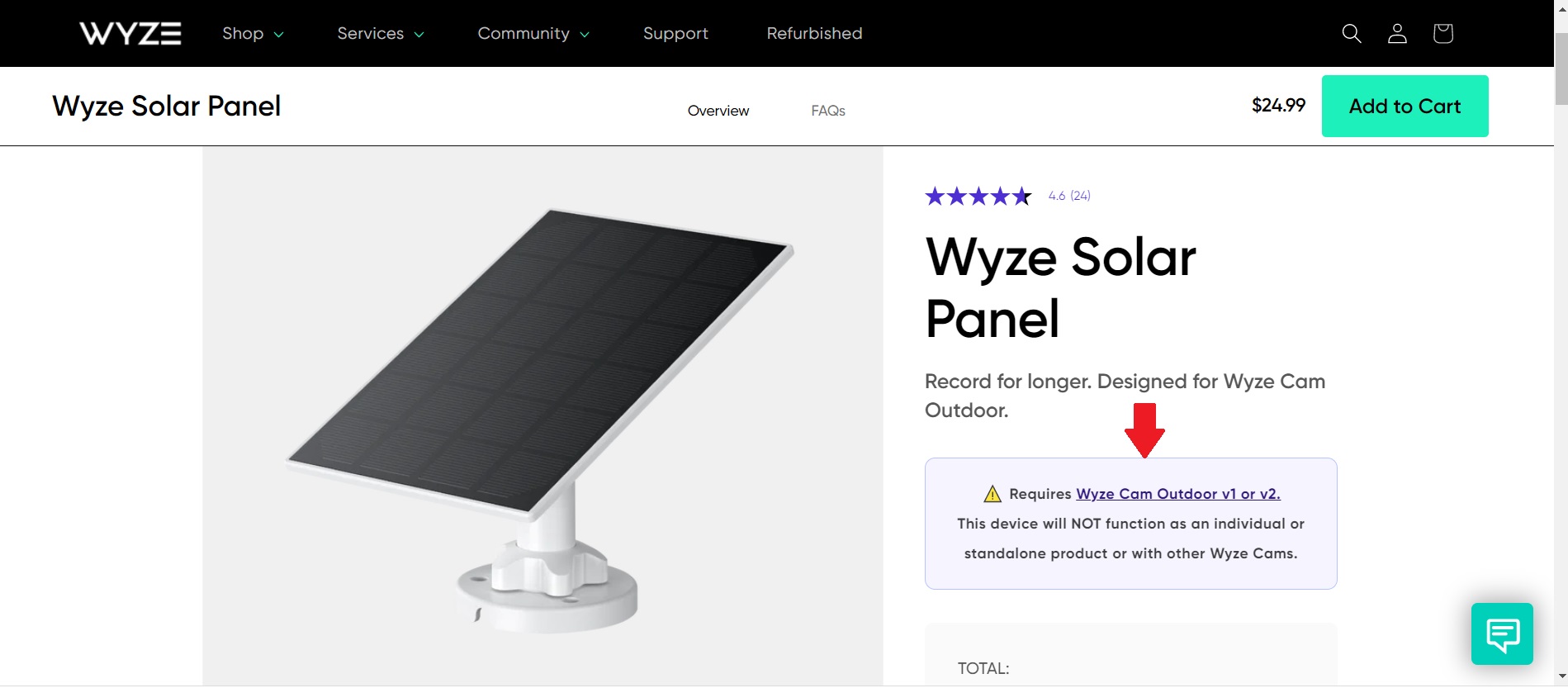

Understand. Thanks. It says Indoor/outdoor so I guess you can. OK, I looked again and it actually says V3. So I guess thatâs it.
Oh, good. It may be worth a try. I think when the panels came out I was discouraged because I was afraid it would not provide enough power and forgot about it; now they are promoting them and we want to use our camera outside now as it was focused indoors on a pet we donât have anymore.
Just to clarify⌠the solar panel wonât power a Cam v3. The solar panel works only with the Cam Outdoor.
âŚand only ancillarily. In âperfectâ exposure to the sun in âperfectâ sunny conditions with low load by the camera and a perfect electrical connection, it âmightâ provide continuous battery substitution. Otherwise youâll be taking the camera down for a charge periodically, much like one without the connection to a solar panel.
Oops. Seapup. Thanks for the clarification! Wyze really needs to do something to make this clearer.
