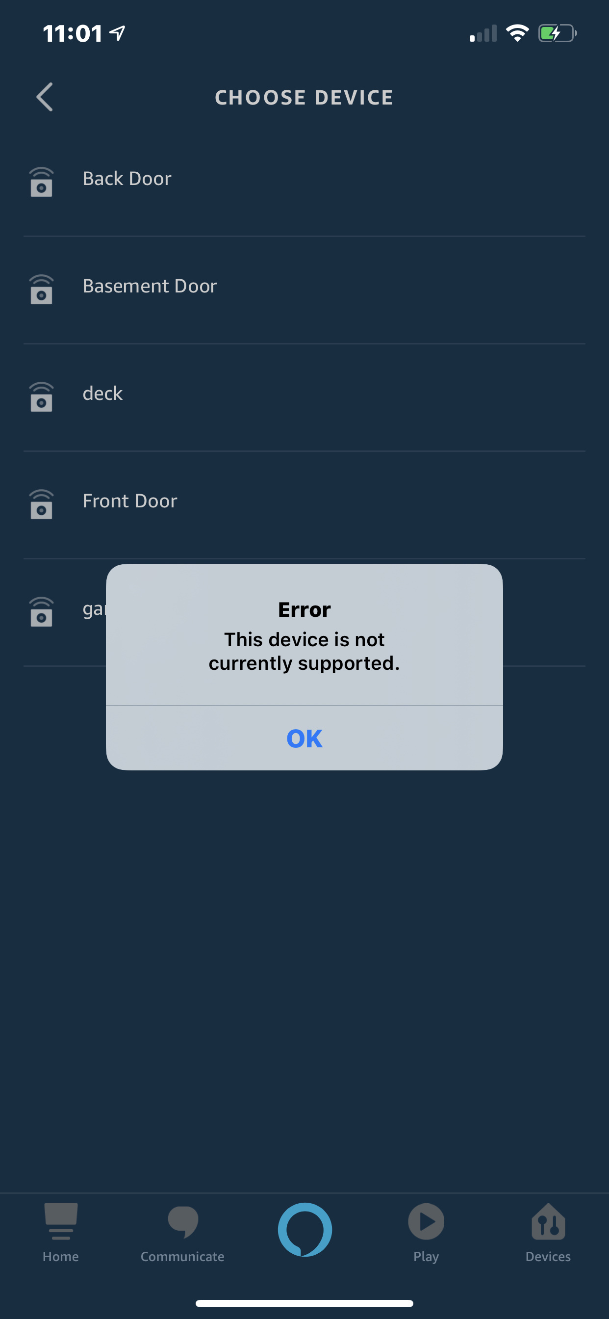

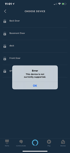

I have been trying and trying to do this, but keep getting the same “Error. This device is not currently supported.” as @korth87 above.
My iOS software, wyze app, alexa app, and camera firmwares are all updated. I’ve tried disabling and reenabling the wyze skill. I’ve tried deleting and reinstalling the skill. I’ve tried deleting and re-adding the Sense devices in both Alexa and Wyze.
I CAN see the status of the Sense device (open, close, motion) in Alexa. But when I create a Routine, I select “when this happens”, then Smart Home, then the Sense device, and immediately that error pops up.
Any help or suggestions?
What type of device is it you are adding? A contact sensor or a motion sensor?
You said you can see the devices in Alexa’s device list, if you select one there it should show you it’s status?
If all of that is working fine you may need to open a support ticket with Wyze. I just tried your steps with a Wyze Contact sensor and it worked with no error so that’s why I think you need tech support.
Although before that make sure the firmware on your Sense Bridge is also up to date.
