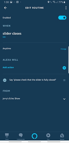

Alexa will recognize your contact sensor as a smart home device and allow you to create a routine with it. My deck slider tends to bounce back open if it’s closed to hard so I made this routine.

Can you show a screenshot of your alexa device list showing the sensors ?
20191107_161544
I have 5 contact sensors and I created a routine for each one of them assigning it to be spoken through the nearest Echo device.
Thank you I appreciate you doing the screenshot .

Do the sensors show up in the device list the same as previous poster? Screenshot please
Yep, exactly like the above screenshot. I could post one, but it would look basically the same, except I’m on iOS.
