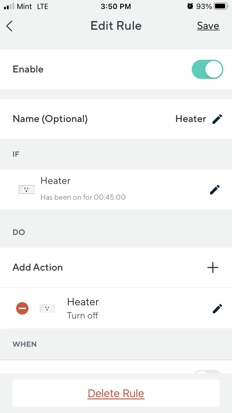

Nothing has changed and I am able to turn it off and on with the app but the rule is inactive, though still there. I have a Wyze router that I learned, too late, despite being in the same location as the combo modem/router I replaced with separate devices, is unable to deliver an adequate signal (internet speed dropped to 60-down/10-up) to my computer BUT, 6 weeks ago I switched my phone to T-mobile and the app is running via it rather than Wi-fi. Recently I had been getting a pop up message about something not syncing that would clear when I clicked on the plug icon. I’m not getting that message now.
When the rule is supposed to run, is it producing an entry in the Rules History?
At the top right of the Rule Edit screen, is the Enabled toggle on?
If you create a shortcut Rule to do the same task as the Rule you are using, does it succeed?
Can you post a screenshot of the Rule?
The image probably answers your question about the rule and what it does, when.
I wish I had known to check the history the first time it malfunctioned. It was several nights ago and I cannot tell from the history when it may have begun having problems. I do know for sure that I have to set an alarm to remind me to turn it off now. Should the blue light be on? I’ve noticed it is not but I have not set it to be turned off. I have this identical run for another plug and it is working.
