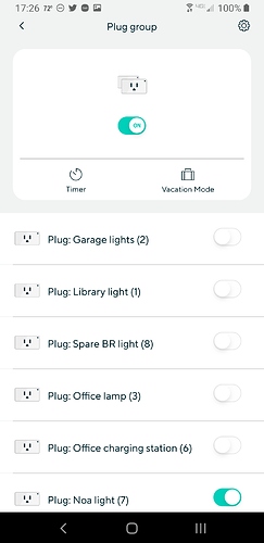

If you have your Plug grouped with other Plugs, make sure the group-level toggle is On:
